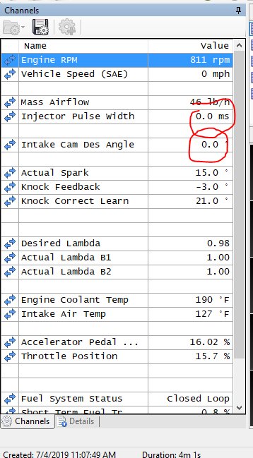

    I'm not getting readings on a couple. Should I open a ticket @HPTuners ?

    Your vvti should be 0 at idle. The IPW however should not be. Yeah. Send them that log as part of your ticket.
