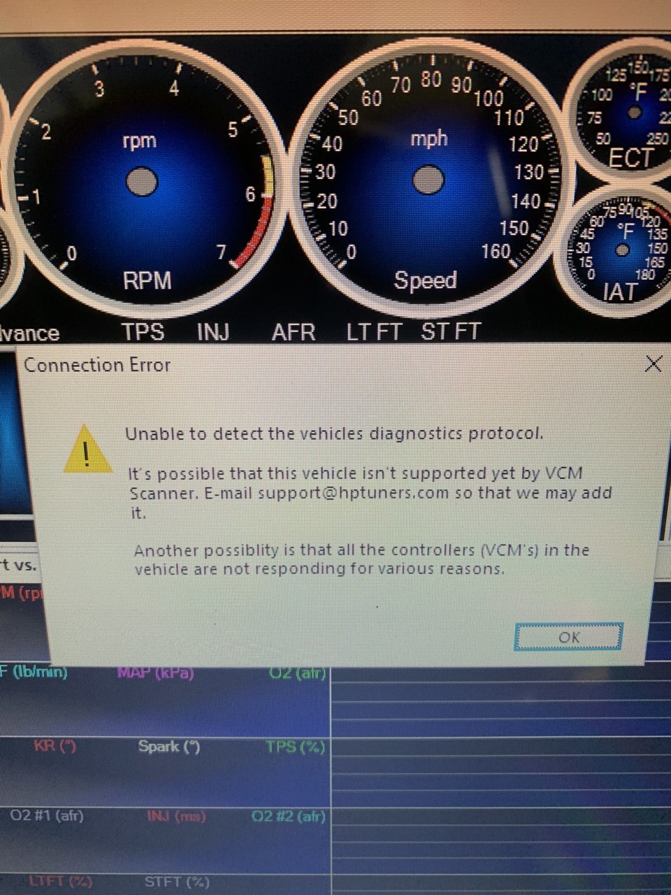

    Just starting getting this, anybody got any tips? It was working fine, unhooked, did some work, hooked back up and this is what I get. Downloaded and installed a fresh copy of the beta and same thing.

    Try to resync interface under the help tab.

    Dude, you are the freaking man!!!! That did it, thanks!
