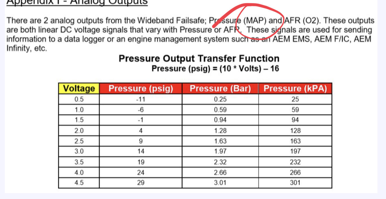

    So, tonight I finally got around to wiring in the prolink to my AEM Wideband failsafe gauge. AEM# 30-4900. This gauge has two analog outputs. One for boost and one for AFR. I'm starting with the vac/boost reading. Everything is wired up and I'm seeing voltages in VCM scanner. Now I need to define them. None of the "canned" options for boost gauges in scanner are giving me good numbers for vac/Boost. Ok, fine. I'll go user defined then. Trouble is, I'm a bit lost there.
    Here's the chart AEM provides on the Boost output signal.
    Anyone else set up a user defined vac/boost reading in Scanner? @JustDSM @HPTuners ?

    That's where I'm at. I've tried all the AEM options. None are reading correctly. One is sort of close. I guess I could start with that one and play with it. But, I'm not sure what exactly to change in the formula. And, more importantly, why.
    Norton likes this.

    Staring at this... what if. What if I set it up as a map sensor instead of a boost gauge. The chart I posted earlier kind of points to this.
    Hmmm

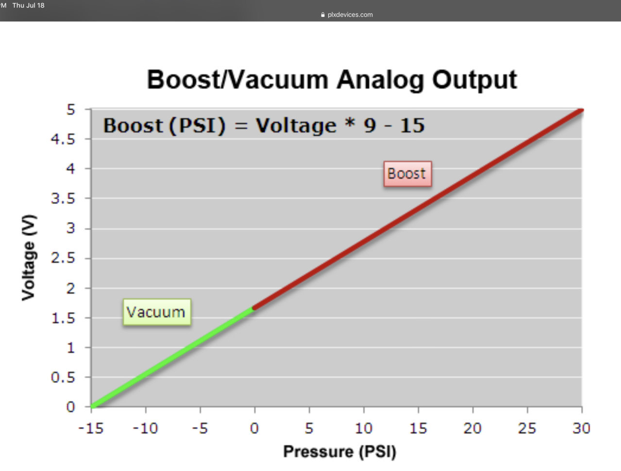

    I see there is a PLX Vacuum/boost option in the list and I believe most of these sensors work on a 0-5v signal so that might be worth a try too if you haven't already

    That map table looks like a proper range for a boost gauge

    Indeed. Very similar numbers. I’ll use this as a starting point.
    And thank you for helping me think it through.

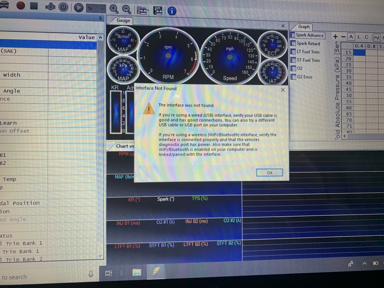

    Anyone else having this go on? I’ve tried 3 different cables in every USB port on my computer. The tone on the computer sounds when I plug in and the MPVI2 pwr light comes on but I can’t connect or re-sync. @HPTuners any quick fixes?
    I’ve downloaded the latest beta already. It was working fine, I unhooked, did a little work under the hood and haven’t been able to get it back.

    hmmm I assume you are getting that error when you click connect to vehicle?

    Yes, it also can’t find it when trying to re sync

    Does it show up in device manger?
    Right click the windows icon bottom left > device manager
    Under "Universal Serial Bus controllers" with the MPVI2 plugged in do you see "USB Serial Converter" ?

    It shows up as FT230X Basic UART
