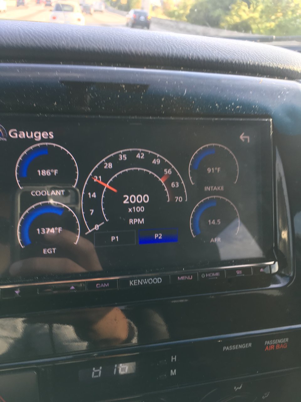

    Follow up question for the gurus - how reliable/accurate are the EGT readings that are pulled from the OBD2 port. I am running the idatalink maestro interface on aftermarket radio and the egt gauge reads almost 1400 deg f when cruising on the highway.. this can't be right, right ? seems waay too high.

    They are not based on actual temps. There are lookup tables that have temp values predefined for each load/rpm.
    You can edit those tables to report any temperature you wish.

    @JustDSM so then these egt numbers I’m seeing are a joke then ?

    Yup. There are no temp sensors in the tacoma exhaust whatsoever.

    Great news, I never really paid attention to these numbers on the maestro interface until just recently, just making sure I wasn’t close to blowing this mf’er up.. time to invest in a wideband set-up
