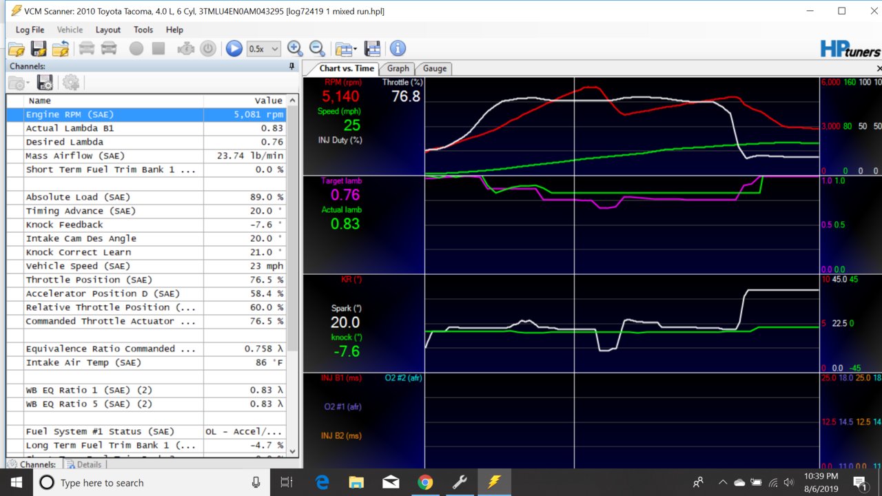

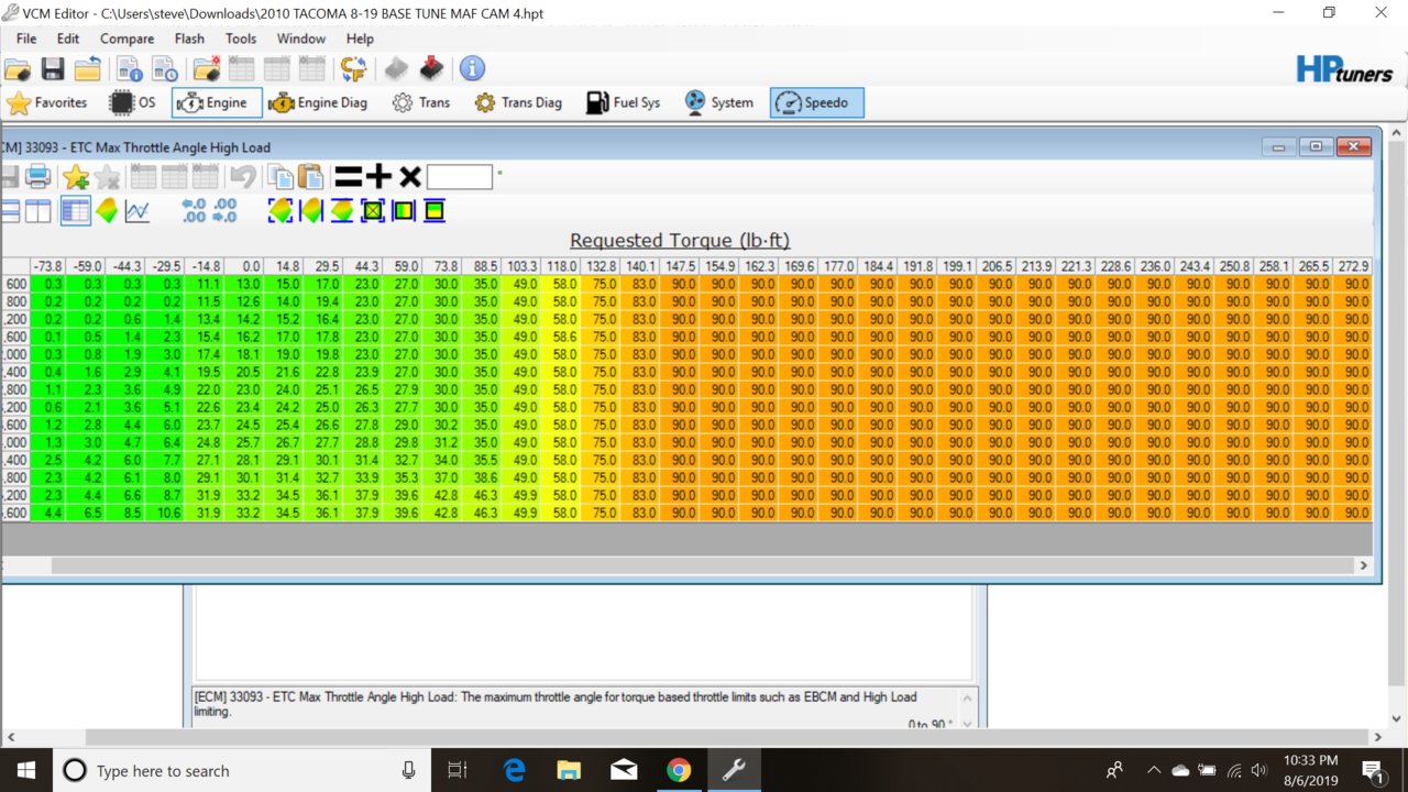

    You can see how the throttle opens gradually and dips a few degrees.
    Again I'm just experimenting to see what happens...
    With the modified map the throttle opens faster, a few degrees more and stays open...
    I modified both maps and now I'm going to put the low load map closer to stock..
    I made drastic changes and truck drives basically the same.... except the cruise control...
    Well this map is used as a torque limit for the traction control, because now my traction control doesn't kick in.
    So we can fine tune our traction control... Still working....

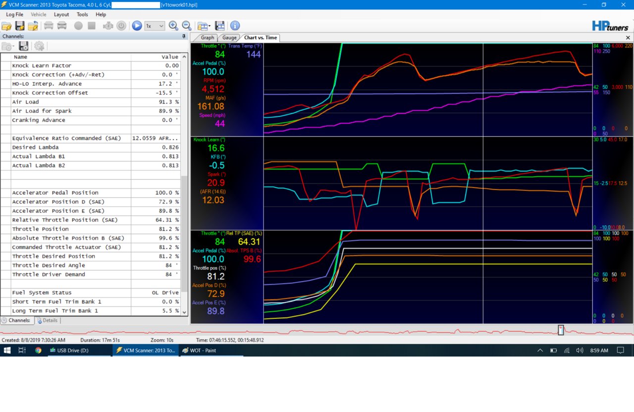

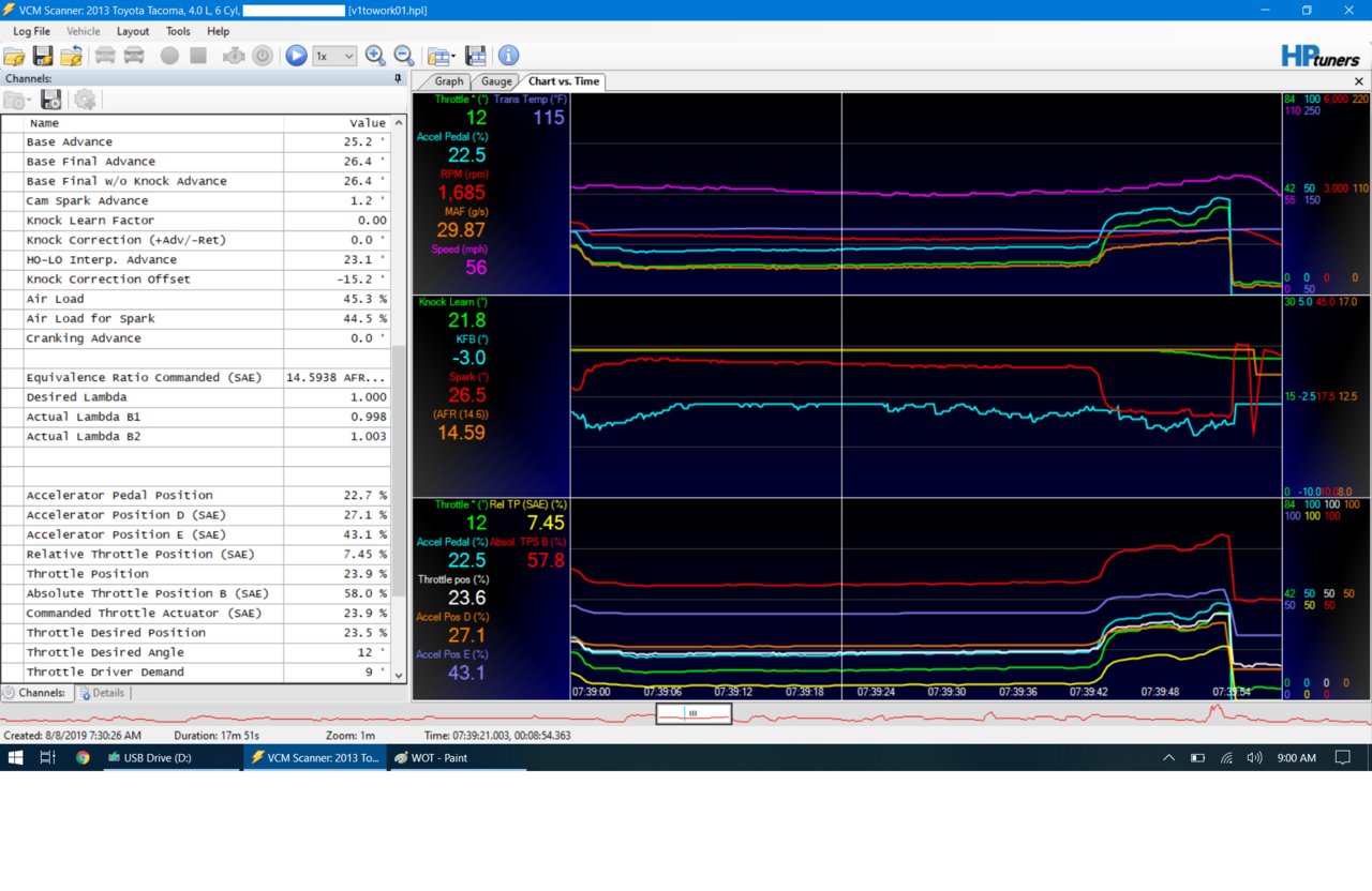

    This is curious. I wonder what your throttle blade angles are during this. There are so many "throttle % numbers" that can be recorded during everything, but i dont think i have ever seen them dip like that during WOT pulls. Here are two screen shots from this mornings logging. First a cruising speed, second at WOT, notice WOT none of them dip. Realistically, Accelerator pedal % (how far the actual gas pedal is pushed down) and Throttle [desired] angle (how far the throttle blade is open) are the main ones to look at, and they act as intended, the other ones... who the hell knows.
    Cruising:
    Wot:
  18. Aug 8, 2019 at 9:12 AM
