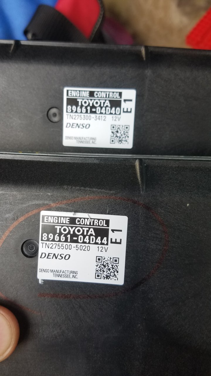

    Interesting to note that when Toyota replaced my pcm they used a different model number. So both should work for a 09 4x4 AT for what it's worth and if it helps someone... Anyways about to try and flash my non trd pcm to trd specs. Should let me limp around till I get a trd reflash done. 20190812_133626.jpg

    So it wont let me flash my old ecm without buying more credits. vin number matches but calibration is of course different. frustrating couple days....

    Im sure a ticket with HPTuners could sort that right up. But from my understating if its not the same cal and part number ecu with the same vin, you wont be able to flash as thats how credits are licensed.

    Ticket submitted. Awaiting response. Is there anything else I can change via techstream to make the ecm the same in the eyes of hptuning?

    I dont think so, considering they are different ECU part numbers.
