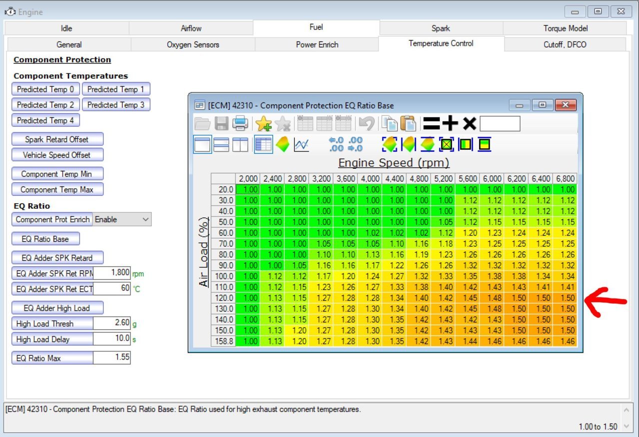

    Attached is the commanded AFR the truck will shoot for at >75% throttle (stock)Enrichment.jpg
    But that's only half the story... You might ask, but my TRD tune runs richer than that.. Well, I know why. :)
    And it's due to the cat over-temp protection built into the ECU. This right here is what ruins the fun, even for my lowly little N/A truck. There is a number of maps that are referenced which tell the truck how hot the cats and WB O2's are in the manifolds. When the ECU determines these are above temperature it can dump upwards of 35% in N/A trucks and up to 50% in S/C trucks fuel over the baseline fuel calculations.. This.. This right here is why the TRD tune in stock form runs so damn rich..
    It ruins the fun in my N/A truck too.. But thankfully that can be turned off for those running headers. The guys with stock manifolds will need to decide if they want have adequate AFRs for power production, or long-living cats..

    I'd like to point out that it's not a static 35% but can be up too :) for the N/A folks. Up to 50% for S/C trucks, though the correction is a little more "forgiving" in the S/C trucks than the N/A.

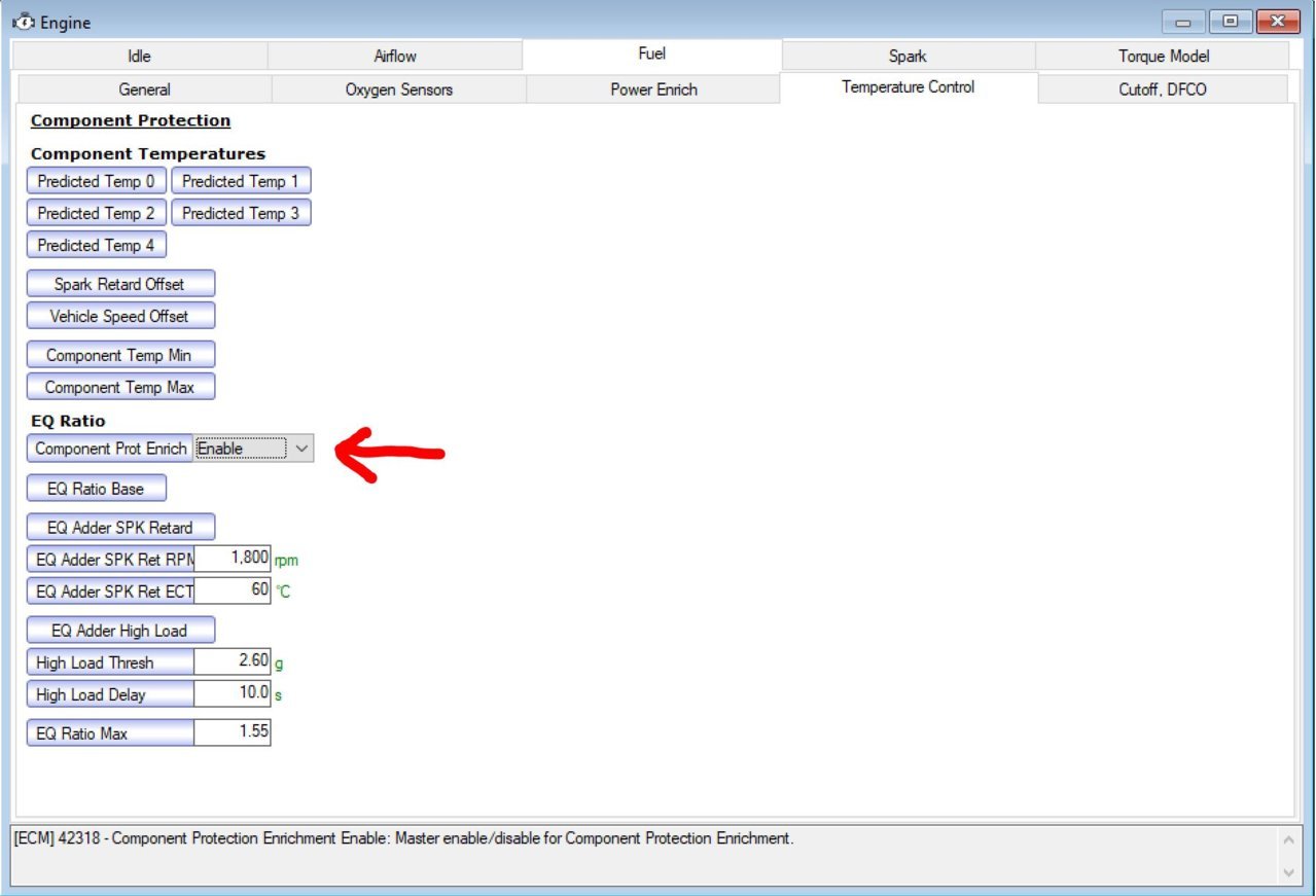

    The 12 MPG city mine gets doesn't bother me, but having additional range and less stops for fuel is a good thing. The LRA 33 gallon fuel tank helps a lot with that, but more range is always welcomed!
    For those with headers or no care about protecting the cats, this can be changed to disabled to turn off component temperature protection. Keep in mind that the component protection is also for the WRAFs, so the life of the WRAF's may be affected.
    A screen shot for visual aid showing up to 50% over the normal equivalent ratio:
