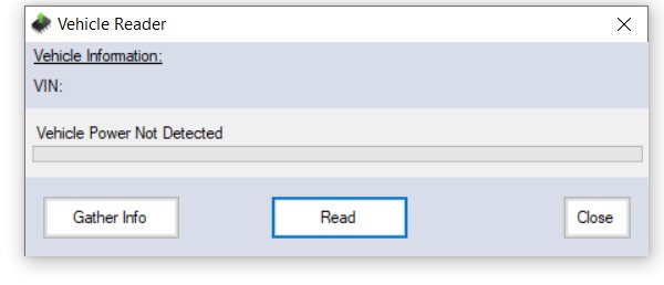

    Check your fuses, and then verify that there's 12v and Ground at the OBDII port.

    12.9 V and all fuses seem to be good. Any other thoughts for me to check when I get back in a few hrs?

    what was your install procedure on the software?
    have you tried opening vcm scanner and connecting to the vehicle (no need to be running but key to ON)

    I think I'd gotten something like that. I had to ensure that the module was in the port very well. It actually took a couple tries to get it seated properly.

    Use a dvom across pin 16 and pin 4. Should read battery voltage.

    Checked that earlier and had 12.9V

    Bingo this is what it was. Wiggled it around and could see the obd and host lights on the module start to flicker. Never had this issue with my regular obd scanner. @JustDSM you will have an email inbound shortly. Get to it when you can. Thanks everyone.

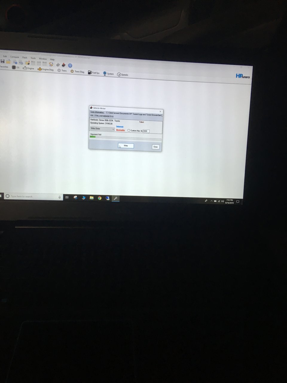

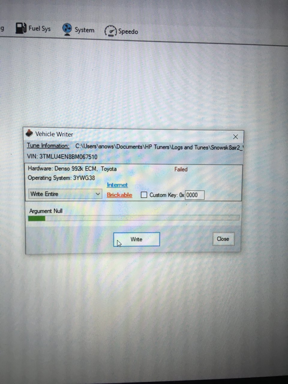

    Though I did just notice this. Argument null and failed? Do I disconnect or keep waiting? @JustDSM

    Are you connected to WiFi? (You'll need to be if not).

    I am, but it is super shitty at my house. Especially in the garage.

    I suspect that's your problem. If you can, use your phone as a hotspot. You'll want a decent connection as there has to be comms between your computer and HPT servers for the flash process.
    If there's anything you can do to improve signal strength in your garage, I'd do it for the few minutes the flash takes :)

    Yeah, I've seen that error pop up when I'm on the road tuning and away from the house and I've forgotten to turn on my phone's hotspot. It's one of the "fails" that wont screw the pooch as the communication between your PC and HPT needs to occur before the flash actually happens.

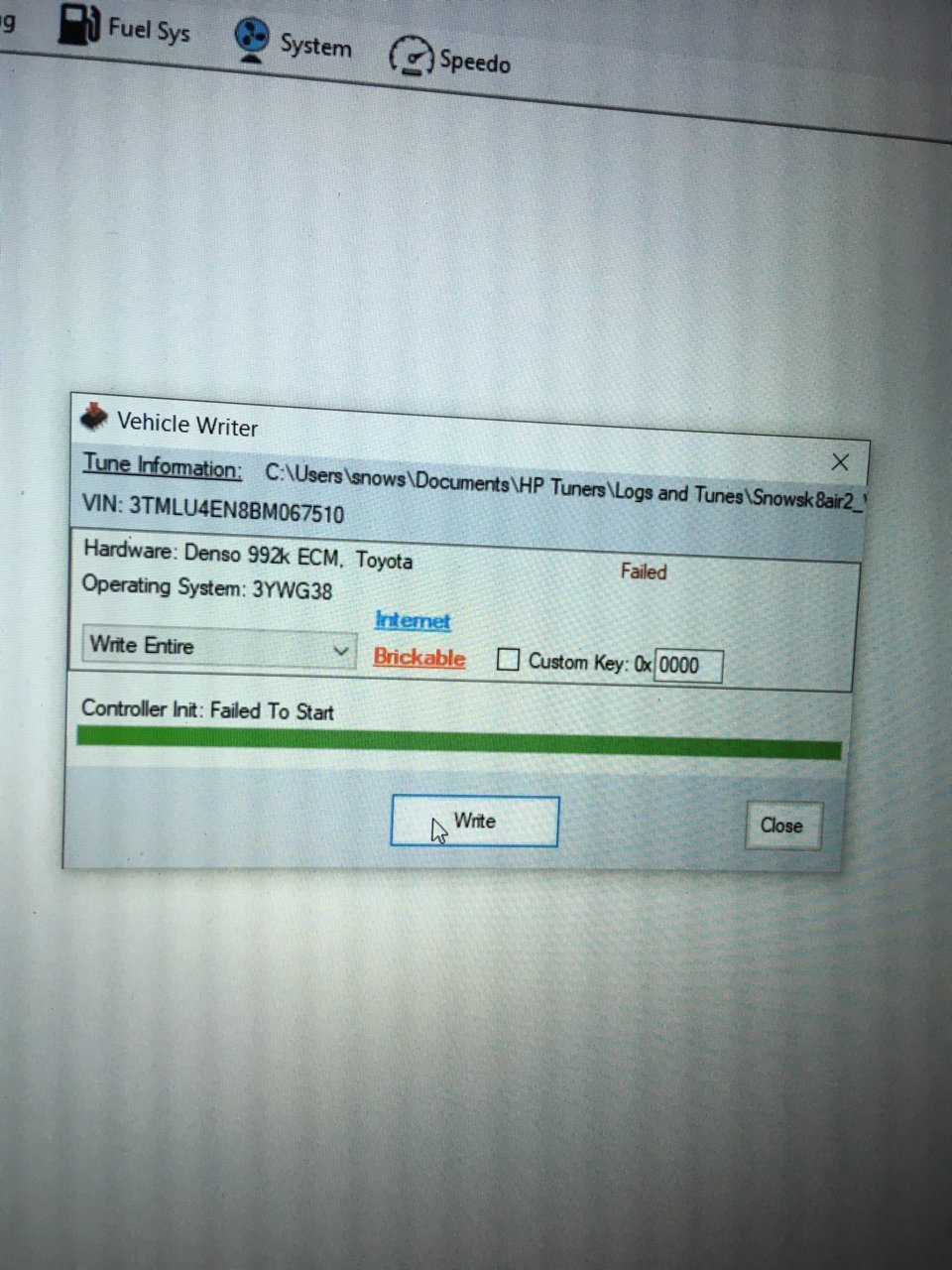

    Now I’m getting here and failing. Thinking this might not happen tonight.
