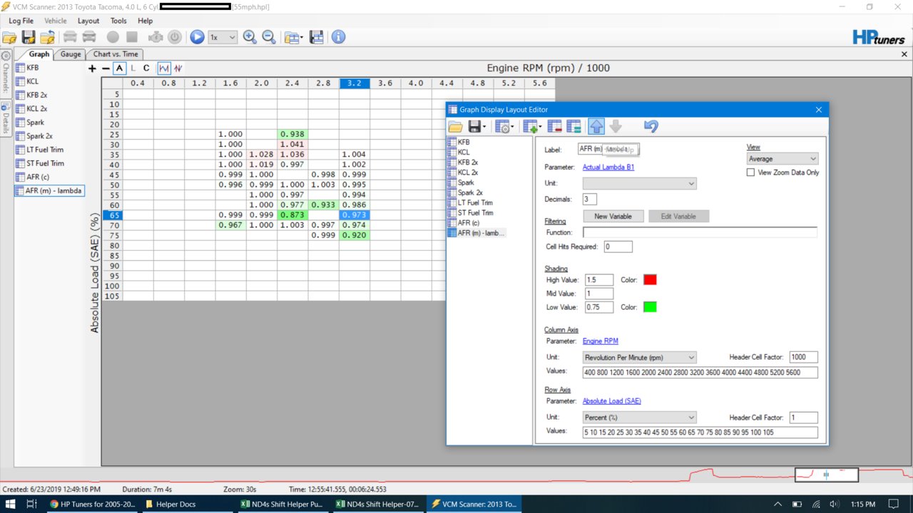

    @JustDSM, @loginfailed might know the answer to this. But is there anyway i can add a multiplier to the values here in this chart (IE 14.6) so i can see actual AFR's vs lambda values?
    EDIT - Looking like i could do a math parameter and add it to channel lists for future logging, but was wondering if i could take previous logs and do what im tying to do.

    Lambda = A/F divided by 14.7 (general number...it differs for different types of fuel)
    [Edit] ND, you'll want to create a custom math parameter to convert lambda to AFR (Gasoline) and then create a new graph that references that math parameter along with your defined axis parameters/values.

    Yeah, Lambda is what the truck spits out for measured AFR's, just want to make it into a value (x stoich .... which is 14.6 as defined in our tunes), that my brain can easily process.
    I think i figured it out.... but what should my multiplier be, 14.6 which is the "Stoich" that the tunes target or actual stoich of 14.7?

    I'm sure you're running some blend of ethanol in your fuel, so I'd go with the 14.6 value.
    Let me know if you need a hand with the setup. But I suspect you'll get it figured out :)

    Yeah.... what im trying to do is already built into VCM scanner.... problem is i recorded channels of Lambda not the transformed channel haha. So its all good! I got it figured now after playing with it for a bit.

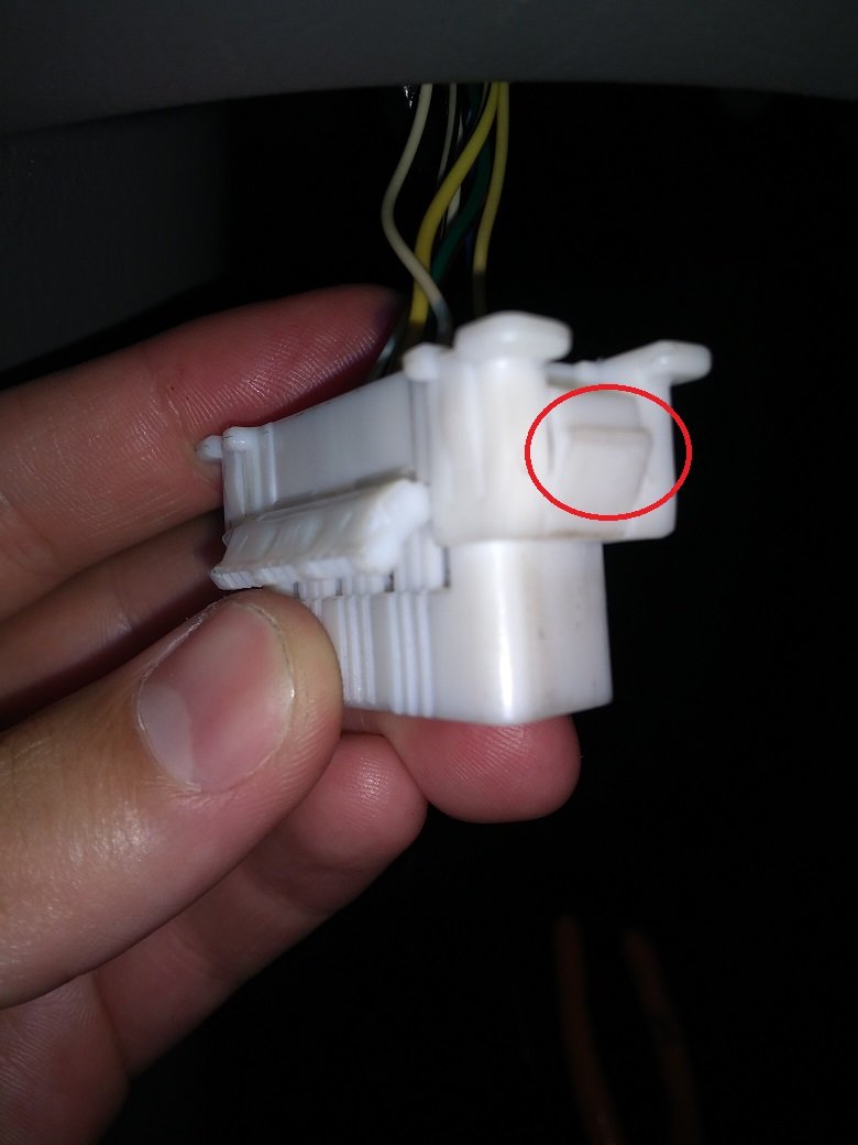

    Going to piggy back off of this. Currently running on my Backup Ecu which isnt being touched until my original gets back from being restored from @OVTune. And decided to go through and check my OBD2 port pins before doing some logging of the stock CAL, as I had never gotten any stock logs!
    I have a lil ELM327 bluetooth adapter that ill plug in sometimes to monitor trans temps if im towing but id say 98.6249% of the time there is nothing plugged into my OBD2 port....
    That stated, it looked like a my OBD pins had been massacred by mandingo - ALL OF THEM. Im honestly surprised that the MPVI2, or anything OBD related actually made connection due to the spring tabs being so flattened out (this might of been my issue with my bricking flash o_O).
    I took a few pictures for those who would like an explanation of how to properly pull the pins out of the OBD port.
    Get up all underneath the dash, Below circled in red are the clips that hold the white OBD connector in place to the dash plastics, one on each side. There is also a small harness holder about 3-4in up the harness that you can remove (with similar clips on each side) from the dash as well to make things easier.
    Before you start, make sure to take pics of the back of the connector so you know where each wire goes, and only remove one wire at a time to not get things mixed up.
    Once you have the OBD port in your hand the first thing you need to do is flip open via a very thin flat head (or something of the like) the lil "door" pictured below just above my thumb, there is one on each side of the connector which is the first of two "locks" that hold pins in place.
    Once you have the door open, then look dead on at the OBD2 connector, Circled in red is the second "lock" that holds pins in place. To release the pin, use a pick to pull up the lock towards the center line (inward) of the connector (red line drawn) and the pin will come right out. Then you can follow the above to re-bend the pins spring back a bit to put more pressure on connections.

    There are connector extractor tools that'll make popping the metal connector out a breeze. Search "Molex connector extraction tool"
