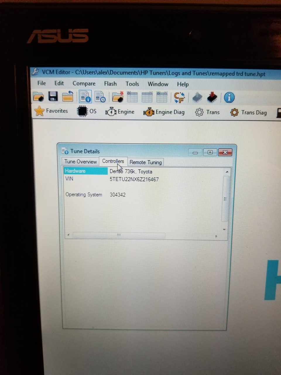

    i highly dought hp tunners would lie to me about it being a modded n/a map for a supercharger... but for fun see what the asic valve is like on your software. i am not digging this way of tuning like how are ya spoosed to fix ugly blips in the map???

    What is your Calibration ID or OS Version (in VCM Editor)? That'll clarify exactly what you have.

    FYI You cant flash an NA cal'd ecu with a TRD cal via hptuner. I guess you could mod the NA cal for use with a supercharger but damn... that would be way way less than ideal. Also ACIS stock is only activated (in long intake runner mode) between 2200rpms and 4100rpms under high tps (60* stock i think). If you had a proper TRD Calibration'd ecu, you would not have the option for ACIS.

    All look into it after work but i did see a tab for acis pretty sure that dip i had witht the x1 and now with the hptuners but far better just goes pig rich in roughly that are of the rpm at certon throttle point

    That sir is a standard naturally aspirated 2006 4.0L calibration.
