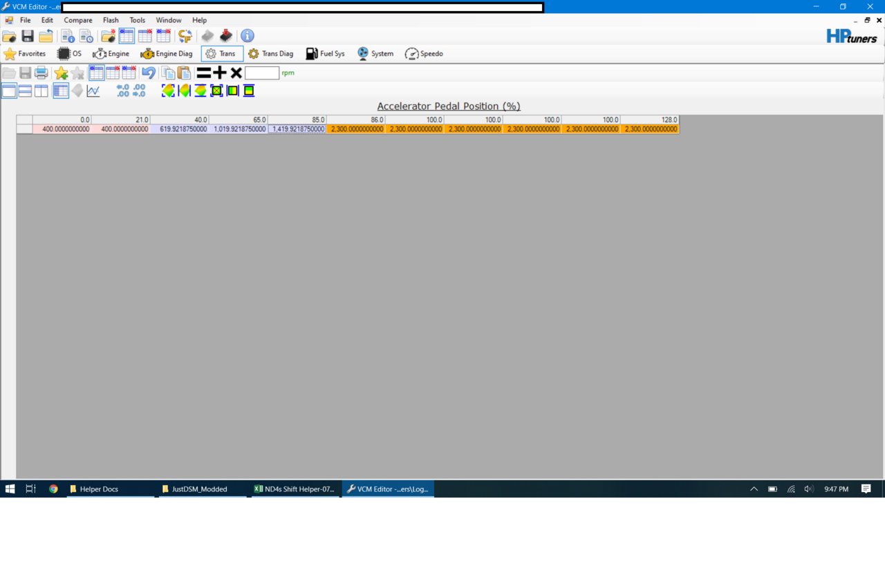

    @HPTuners, and maybe @JustDSM? Can yall comment on things like this, an rpm value where one would expect to see whole number values have tons of decimal points?

    I haven’t come across that anywhere, yet.

    Expand out (show a few decimal points) say the throttle pedal mapping values and you will see what im talking about.

    That makes sense, I’ve never expanded the decimal points. Gives you finer tuning over the values if necessary.

    Its just weird tho, like why would some cells (specifically in the auto trans tables) be limited to say whole numbers in 25rpm driveshaft rpm increments and others, have wacky decimal's with seemingly no rime or reason haha. Either way still works!
    (the OCD in my would just like whole numbers is all haha, it probably has to do with the byte to decimal conversion for values).

    The editor will round the values to the nearest allowed value. You don't have all this precision in reality. ie. when the editor converts the decimal number back to hex the scaling factor used determines the resolution. Most toyota values are stored as BCD not floating point numbers.
