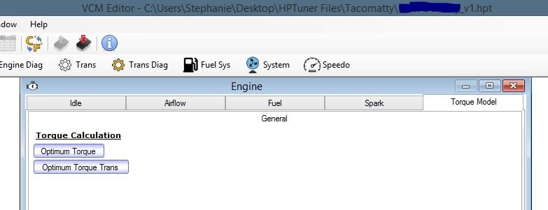

    Why don’t I have a “torque model” tab in my tune? Is this something that was added in an update?

    JustDSM
    JustDSM Oderint Dum Metuant
    Jan 16, 2015
    #146525
    3,260
    Justin
    Ogden, UT
    What version of VCM Editor are you running?
  10. Aug 24, 2019 at 10:53 AM
    #4350
    Tacomatty
    Tacomatty Well-Known Member
    Oct 13, 2015
    #166585
    132
    Long Island NY
    2015 dclb sport
    Supercharger, walbro 255, 3* retard cam gears, AEM boost and AFR gauges, JustDSM tuned, ome 887, dakar leafs, bilstein 5100s, katzkin leather
    4.5.493 beta
  11. Aug 24, 2019 at 12:30 PM
    #4351
    JustDSM
    Jan 16, 2015
    #146525
    3,260
    Justin
    Ogden, UT
    Odd. Shows up on mine, same version of software.

  12. Aug 24, 2019 at 12:42 PM
    #4352
    Tacomatty
    Oct 13, 2015
    #166585
    132
    Long Island NY
    2015 dclb sport
    Hmmm that's weird. Maybe I need to uninstall then reinstall VCM editor? Or maybe I have to check something in settings?

  13. Aug 24, 2019 at 12:51 PM
    #4353
    JustDSM
    Jan 16, 2015
    #146525
    3,260
    Justin
    Ogden, UT
    Very much appreciate the feedback! Thank you for sharing.
    I think you might want to go to the "Edit" menu, and down to "View" and click on Advanced. That might be why you're not seeing everything.
