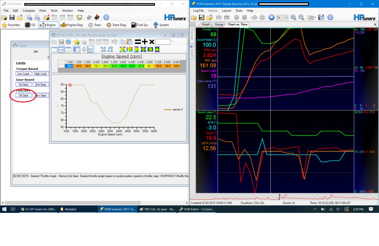

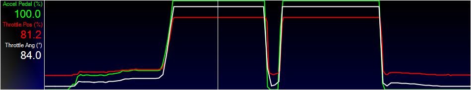

    I noticed that on my NA truck the throttle was not snapping open but gradually opening and not holding full throttle...
    I found the torque based throttle was limiting my throttle...
    Good news it also seams to control the traction control throttle limit.
    Bad news it is also used for cruise control, so fixing the throttle and having a usable traction control made my cruise control go crazy...
    I'm still working on it... Maybe something else also controls the throttle...
    I may have to build different maps for different uses...

    Where at were you seeing that? Not one of my logs do i ever remember seeing any dips of throttle plate angle even tho the accelerator was buried.
    JustDSM likes this.

    Stock torque/load tables.

    that's how it should look.
    I posted a pick a few weeks ago but the logs were rounded and had a dip in throttle.
    Drastically changing the torque maps fixed it and softened up the traction control but made my cruise control go wacky..

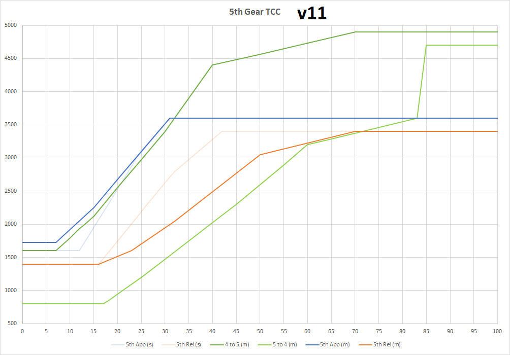

    A day late, but here none the less..... V11!!!!!
    V10 Here - https://www.tacomaworld.com/threads/hp-tuners-for-2005-2015.600793/page-184#post-21086515
    Changes from the V10
    3-4 upshift + 80 ds rpm 0-25 ap% +100 @ 40 ap%
    4-5 upshift + 100 ds rpm 0 - 30 ap%
    3-2 downshift + 20 ds rpms 0 - 21 ap%
    4 tcc release - 150 ds rpms @ 40 ap%
    5th tcc apply - rescaled axis, changed values
    5th tcc release - rescaled axis, changed values to base to go back to stock but still hold on longer in the throttle
    Essentially, hold on to 3rd n 4th gear a lil longer, slightly change the 3 to 2 downshift at low throttle inputs to reduce lugging, Majority of the changes are with TCC. Moved back up to stock base DriveShaft rpms for 5th release and matched modded downshift curve with re-scaled axis, did the same with 5th Apply to match curve of modded upshift curve.
    Here is quick gif of the difference of 5th app and 5th release curves
    Some might not like how aggressive lockup is held in 4th gear. I 99% of the time use 4th gear as a climbing gear, wherein I want to be able to bury my foot into it in lockup to make it up a steep grade without creating extra heat. If you dont like this let me know and ill come up with some closer to stock not as aggressive 4th gear tcc release values. Essentially if you are in 4th lockup, and above 45mph, it will NOT unlock until it downshifts to 3rd, which at freeway speeds of 65+ is around 75% accelerator pedal.
    The BIGGEST THING TO NOTE: If you are inputting these values into your tune take note of the BRIGHT RED highlighted axis and cell values in 5th apply and 5th release. THESE ARE NO LONGER DIFFERENCE VALUES as the axis values have been changed.
    As always, i assume no responsibility, but also as always, feel free to hit me up with any questions, help, feedback etc!
