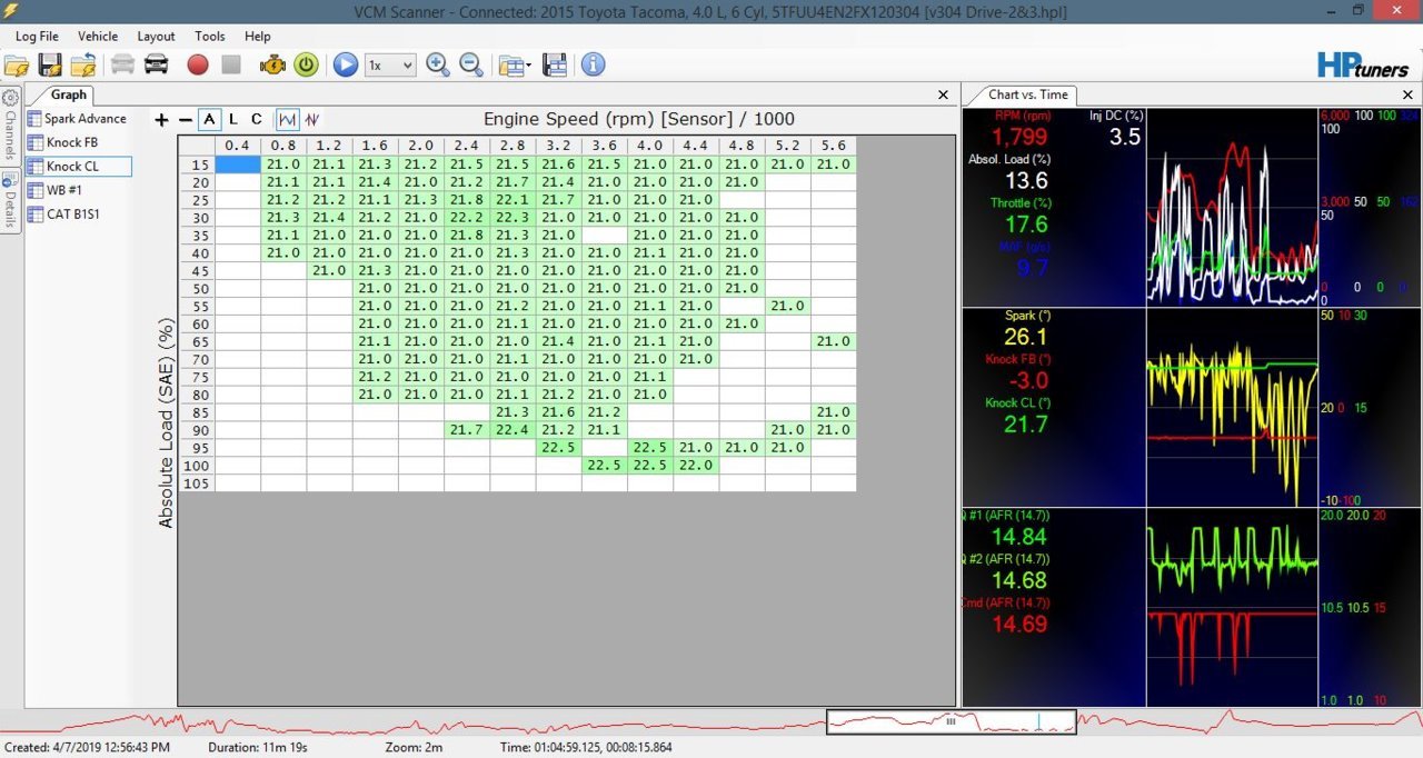

    Base tune for 91/93 Octane N/A trucks is underway and looking good. Very impressed with the Knock Feedback Correction values. Anyone with a MPVI2 and a N/A truck want a free tune?
