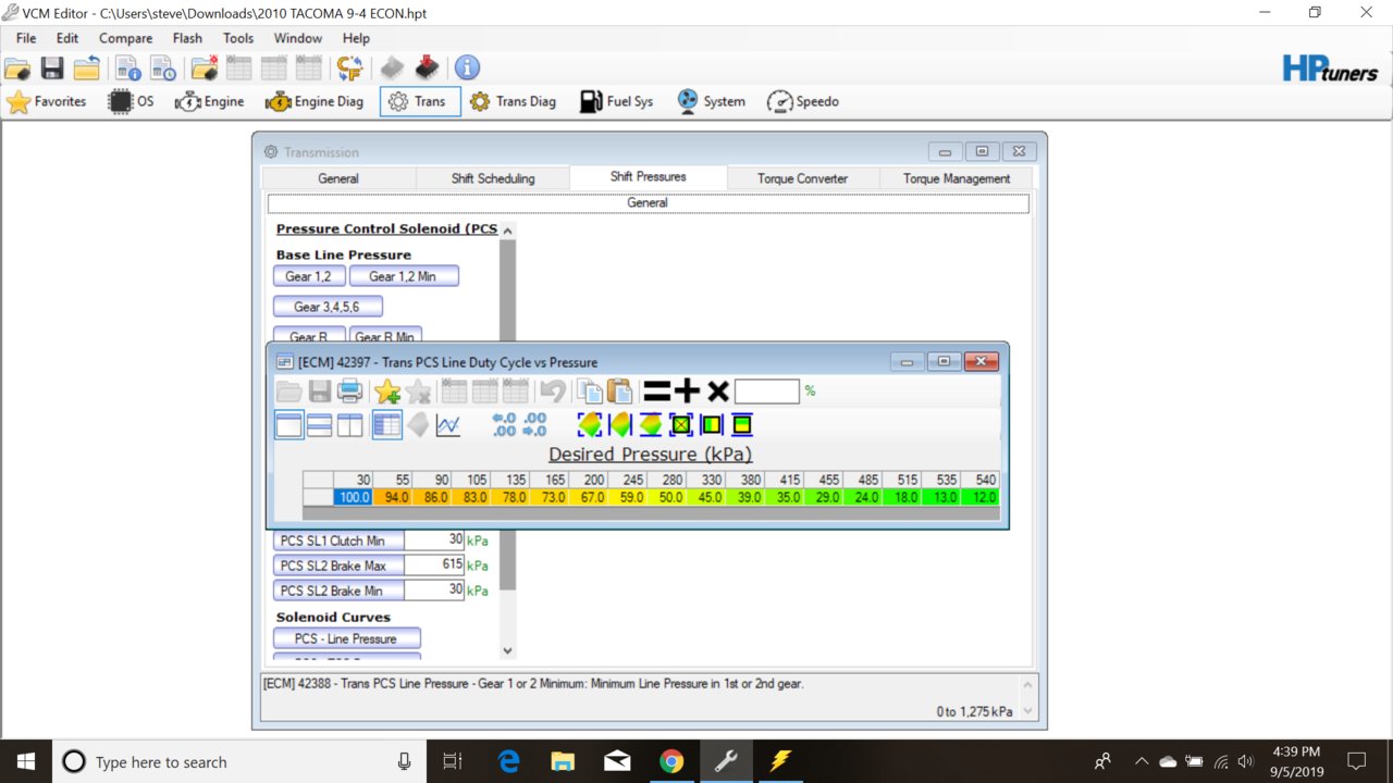

    PCS line pressure, lower number seams to shift faster, I moved it up and it was shifting really slow, now I moved it lower than stock at the high end and it shifting much better and a little quicker than stock... I left it stock for lower rpm for now.

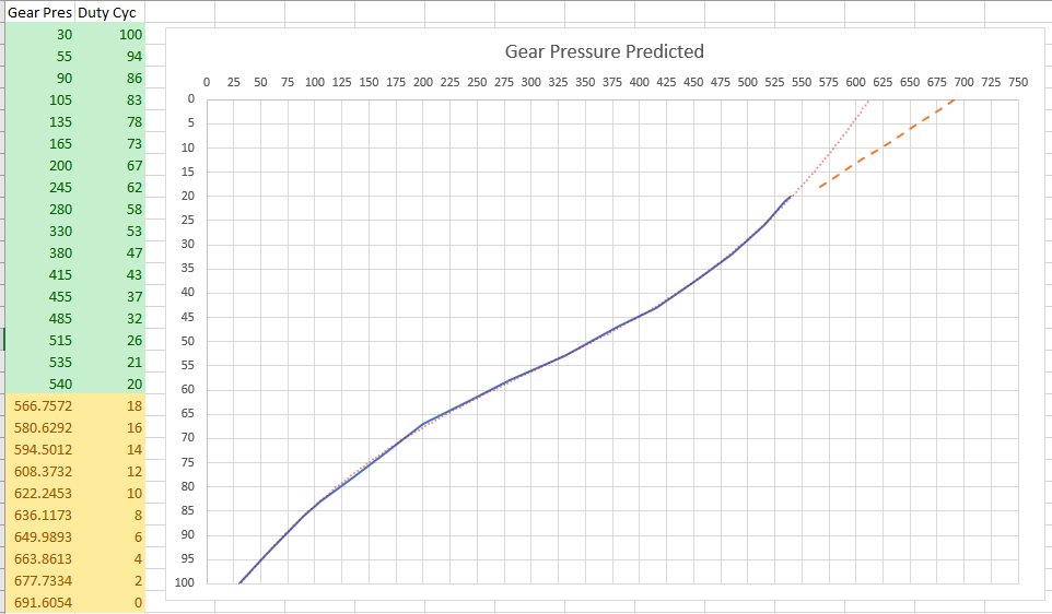

    Yup that would be the right way to go, The lower the solenoid duty cycle the higher the pressure, effectivly making it to where when the system requests say 540kPa of pressure it gets more because the duty cycle is lower than the stock of 20 % duty cycle.
    I always wondered why the ecu doesnt come setup to use a full duty cycle from 100 to 0 for the PCS- Line Pressure and PCS - TCC Pressure. Effectively leaving pressure on the table for PCS Line pressure due to the inverse nature of lower duty cycle = higher pressure, but lowest duty cycle stock is 20...
    I wonder if "bad things" can happen if you fully shut or open (depending on how that solenoid works) as you get closer to 0 duty cycle.
    EDIT.... i got curious and threw numbers in excel for a lil prediction and visual representation. Stock curve is the blue line, orange dashed line is a linear forcast based on stock data, dotted red line is a 3rd poly trendline that seems to fit the stock data VERY well and extrapolated out to 0 % duty cycle, id believe the trendline more so than linear.
    Edit2-I really should get back to work... jezus.
