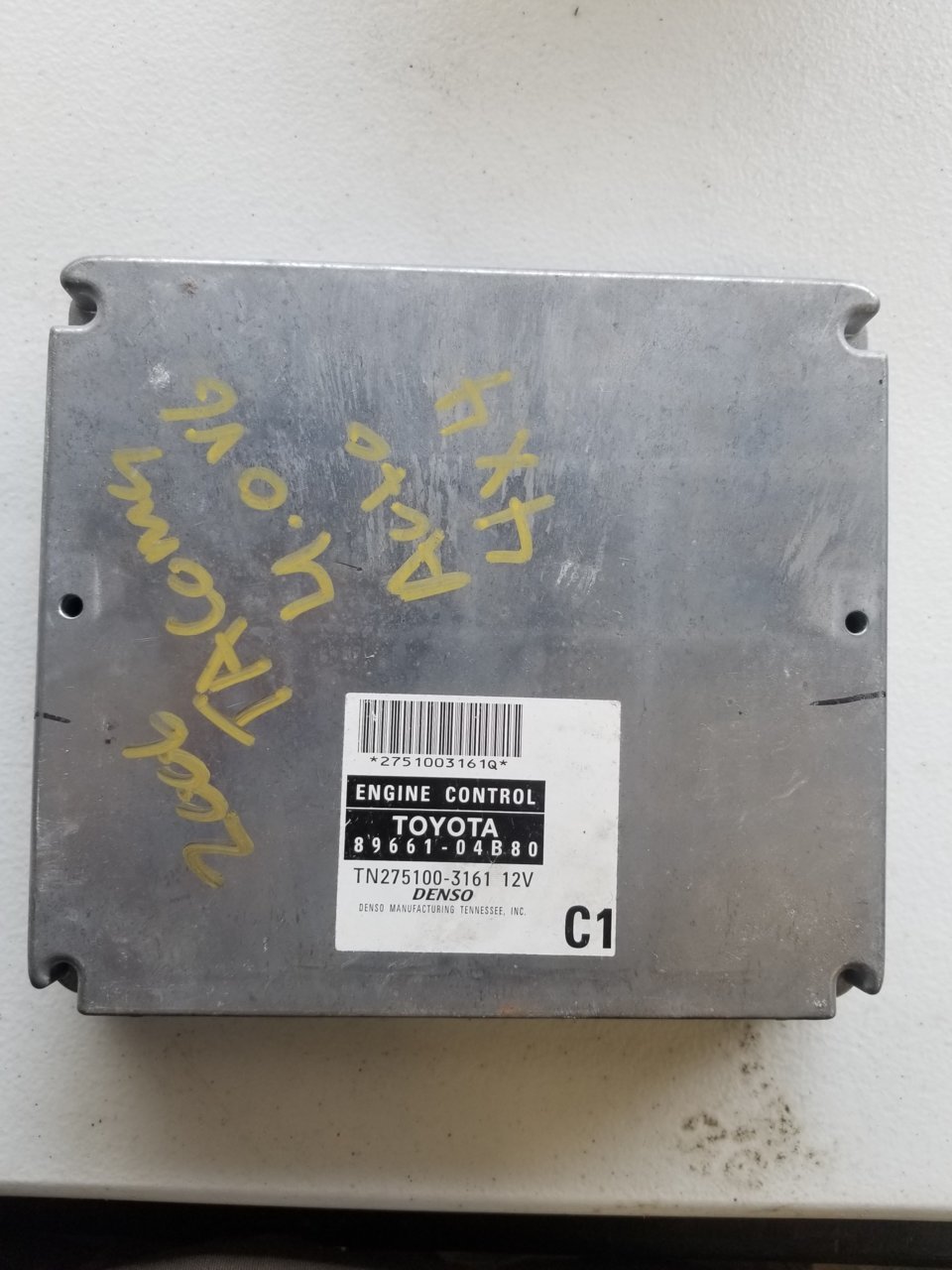

    I’ve already seen two ECUs from 06 trucks (both 4.0 auto 4x4) with different part numbers (last 3 digits) and both # are also different from mine. Seems strange...

    yeah who knows. It was easy enough for me to find the same partnumber ecu... but they used my part number for both 2013 and 2014 4.0L Auto trucks which there are an abundance of.

    I would also note, that if you get a different part number ECU, it's going to contain a different Calibration ID. If you're using HPTuners, that could very well cost you in the long run, as the credits are licensed to the Calibration ID and VIN.

    Yup. Hence why I grabbed the same-part-number ecu as my original. Currently running on the backup ecu, which i used techstream to write the vin of my truck to which resulted in zero licensing issues.

    The number starting 896 is the part number correct? So those should match ? What is the relevance of the number below? The one starting with TN?

    Yes 869991-04B80 is going to be the part number.
    I forget what year they changed the ECU plug style (i think 2012+'s... but it might of been 09+)

    The Box ID could have 1 of 3 possible Calibrations on it, so not 100 percent.
    Original CAL, updated CAL, or TRD CAL.
