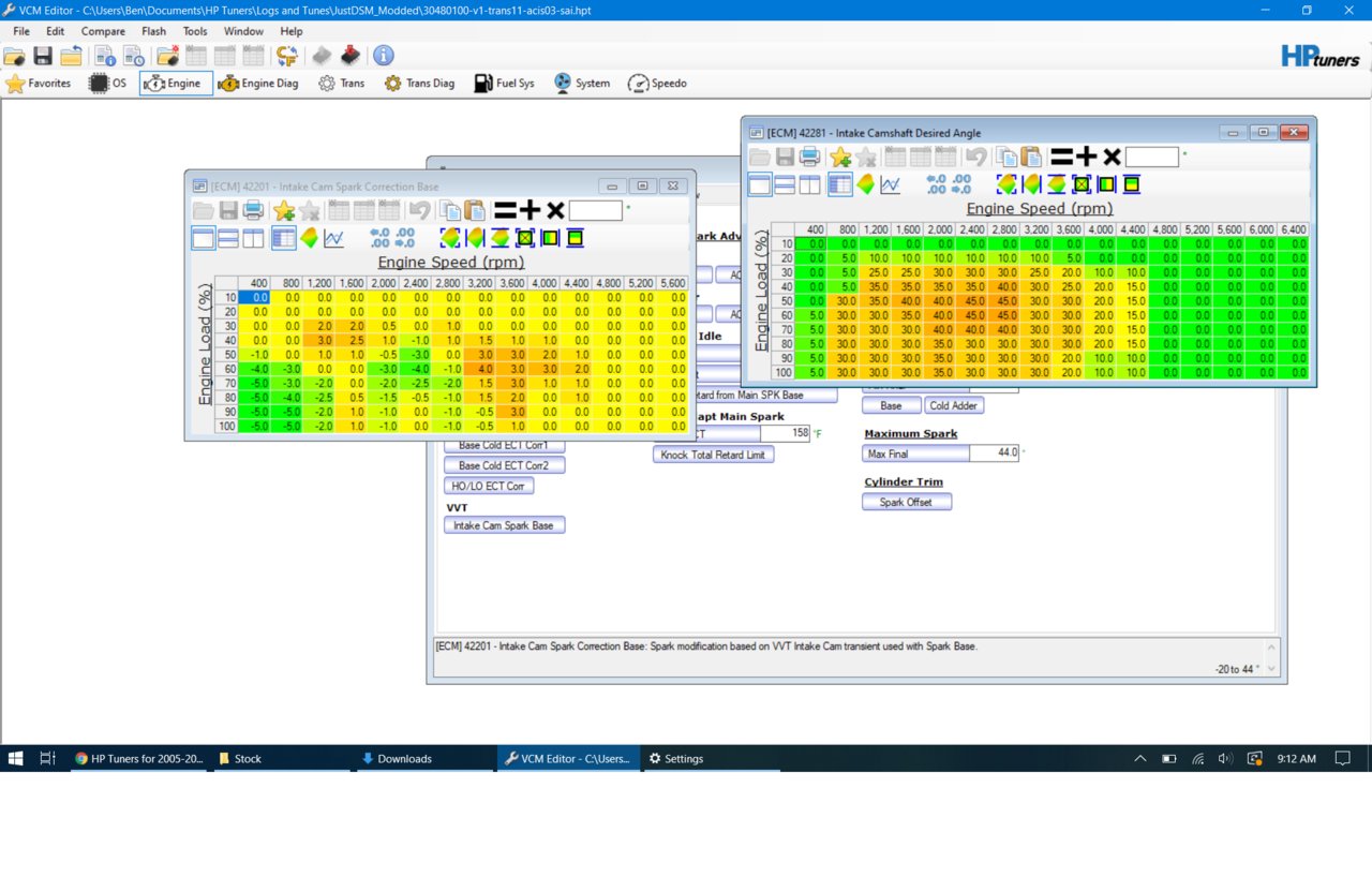

    So spelunking around VCM editor found something interesting spark correction due to VVTi stuffs. Pretty big hole in the spark adv offsets around the biggest vvti values which also just so happen to be the typical cruising loads n rpms.

    Are you saying my fuel map has a nasty hole? Is that why I'm unloading in third?
    Sorry, took me back to the original fast and furious and I'm a little drunk.
    You think pulling the timing back in the cruising area was for emissions testing purposes?

    I need to do some more research on timing and how maps relate to VVTi / intake cam variable valve timing advance as well as how the base timing maps look in that area... there are so many things that affect timing on these trucks its hard to see exactly whats going to be your actual timing number!
