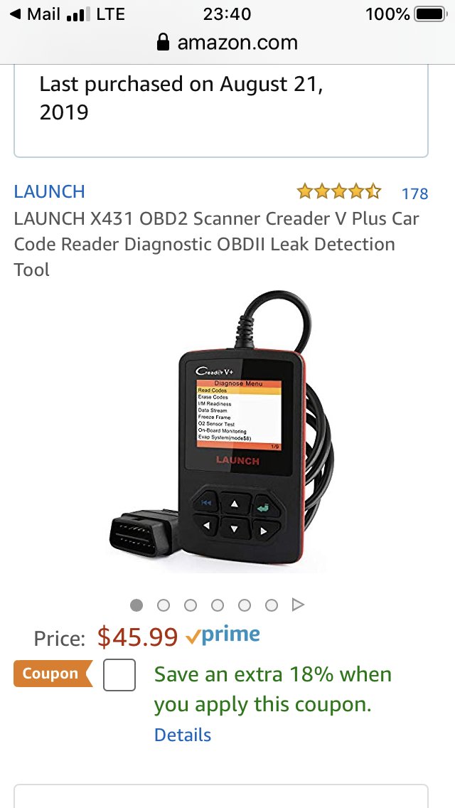

    I purchased this OBD2 scanner and haven’t used it yet. Can I obtain my ECU’s part # by connecting this to my OBD2 port or do I have to remove the ECU to read the #?

    You can check via VIN # at dealer/oem parts store. But most accurately by looking at ECU itself. Sits on passenger side behind dash.

    Remove the passenger kick panel. Stick your phone up between the ECU and the side of the truck and take a pic and go from there.
    You are looking for the Part Number under the "TOYOTA" of the white sticker on the left in the picture below. (pic sourced from the net pic for reference)
