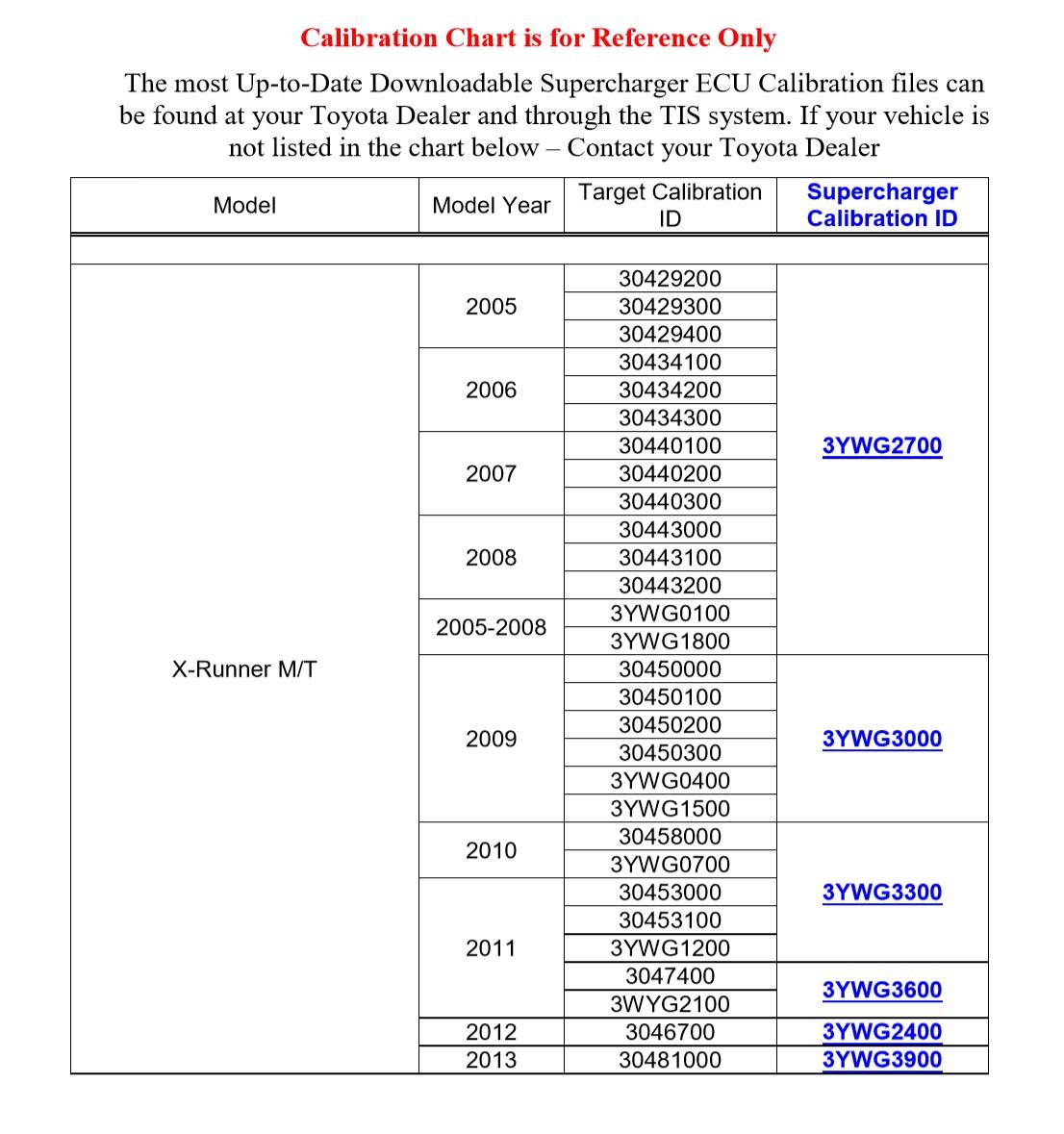

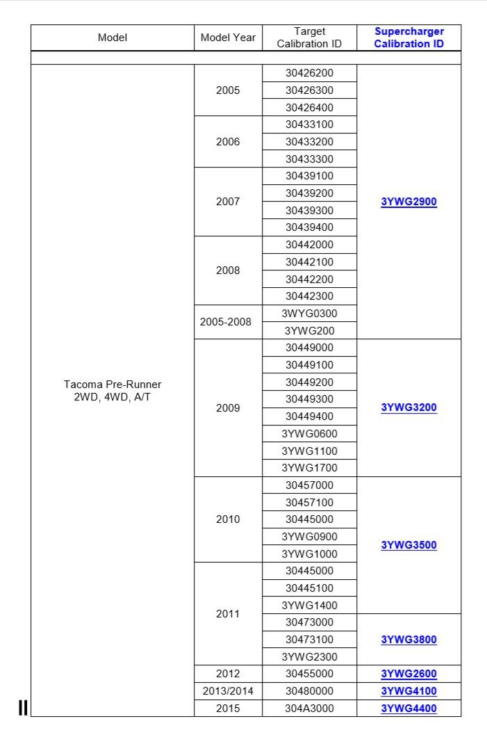

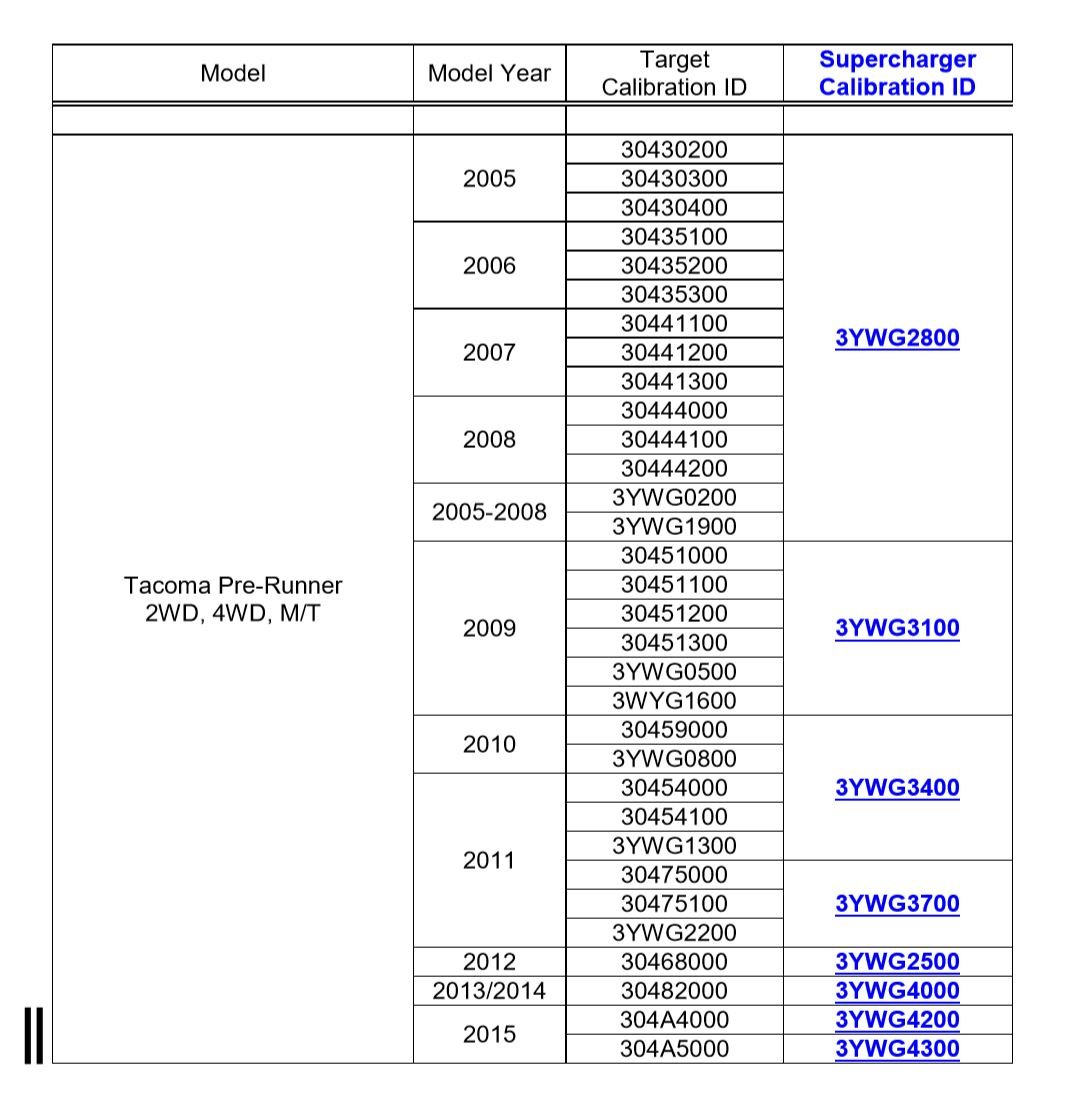

    Here are most of the Calibration IDs

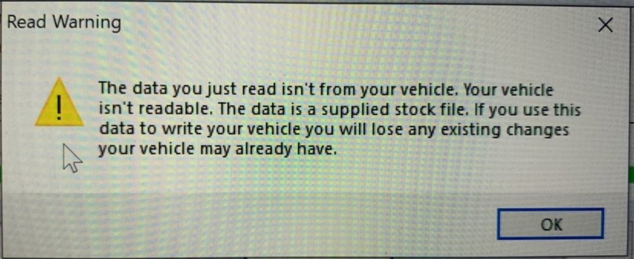

    Can you post a screen shot of the message you get when trying to read your ECU?
    loginfailed and JustDSM like this.

    The HPTuners MPVI2 does not actually physically "read" or "copy" the data contained in the ECU. It's not possible to transfer the tune from the ECU to the OBD2 port. The "read" you're doing is actually a virtual read. Where it references your calibration ID and HPTuners connects to their server, where they have all the calibrations stored on a server. HPTuners then provides you with a COPY of the calibration they read from another ECU with the same version.
    You then edit that file, and when you go to "Write" the tuned file to the truck, the ECU can be written from the OBD2 port, so the file you edit is what will digitally be in your ECU.
    Does that make sense?
    So if you have the TRD calibration, you could read that, but it would not match my calibration in my truck and would probably fail. I'm honestly not sure on this, but HPTuners has stated that they are not going to convert people to the TRD cal on their forum. I'm not sure if that will change, and if it does, how it will be implemented. But at the time of this message it is my understanding that it is not possible.
    I think in time with enough support for this application it's something that could easily be implemented though.. Probably worth all you S/C guys sending them a support ticket asking for that feature, because I'm pretty sure the hardware/software is capable of it..

    I wonder if it's the message where it basically tells you in a long drawn out way, they are not physically reading the ECU and it's a virtual read.
    I'll put a $1.00 down that is the issue. (no offense to you @arcenik) It's kinda confusing and makes you believe it failed. Just click ok through all of that stuff.. I bet you're golden :)

    Exactly what I was thinking.....

    I understand it does not actually read the ecu. I was hoping that if one has the correct super charger tune from some one else that it would flash it. But it sounds like it possibly might if the ecu does not reject it.
    I really don’t get a message from the VCM editor it just says failed to read and goes to 100% really quick. It almost seems like they don’t have my calibration saved on there server.
