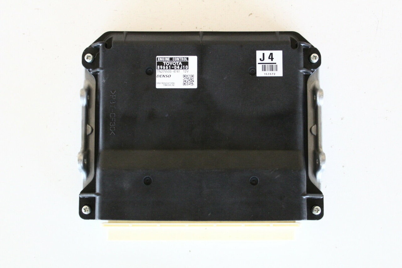

    I’ve never seen a scan tool produce the ECU part number. Of the ones I’ve used (to include Techstream) they report the calibration id number.
    Have you guys seen the actual part number reported by a scanner?

    OVTune
    OVTune Well-Known Member
    Mar 27, 2017
    #214557
    8,112
    OVTune
    Ours does, you can pull the part number off the ecu through CAN
    examples
    Calibration file: 89663-0CJ64 89665-0C700
    Calibration: 30CJ6401 50C70001
    Part Number: 89661-0CM34
    Calibration: 30CM5101 50CA5001
    Calibration file: 89663-0CM51 89665-0CA50
    Hardware: USK5###3URFBE
    Part Number: 89661-0CQ21
    However, it's possible to load any file to matching year of ECU, so I'd say you don't "have" to use the same part number. It's possible to make ECU Clones from any part number (matching the build years, like 09-12, etc)

    Are you saying we only need 4 credits but can flash two ECUs if they have the same part numbers? I thought you had to buy 4 more credits for a new ECU
    12TRDTacoma, JustDSM and Norton like this.
  12. Sep 30, 2019 at 8:27 AM
    #4592
    nd4spdbh
    nd4spdbh Well-Known Member
    Oct 7, 2013
    #114055
    14,621
    SoCal
    13 DCSB TRD OR v6 Auto
    The way HPTuners licenses the truck is via ecu part number, and vin number. If you get the same part number ecu and re-write the vin to match the vin of your truck (easily done in techstream) the software knows no difference.
    I am not saying this to circumvent HPT's licensing setup, just letting yall know that it can be done, you have paid to license your truck for tuning, would suck to have to pay again to tune the same truck due to a bricked ECU.

    HPTuner said it's by Calibration ID and VIN.
    The part number can be the same on an ECU between 3 different Calibration IDs. (N/A, N/A update, TRD)

    Ah yes, thats right. I knew it was something along those lines. Getting a same part number ecu likely means same CAL ID
