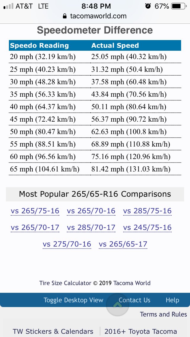

    Man I wish @HPTuners could adjust the speedo for tire size. I’m gonna seriously get myself in trouble just thinking I’m doing the speed limit.

    Just a high price to pay for something that just does that one thing. Though probably cheaper than the ticked I’d get thinking I was only going 5 over.

    If anything you can always just memorize a few of the speed conversions if you dont want to do quick math. With your rate you are at 25% more than actual. Based off my truck Im at 20% which is partially due to the hypertech I have in mine...tried about ten different times to play with it and it just never seemed to work right with my 35s though.
    20 percent isnt hard for me to figure out though in terms of quick math and my golden rule of thumb is to not exceed 70 on the fast highways around here.

    With the hyper tech you have to ignore the hearing boxes and leave them stock. Based upon where your speed gets measured inputting gearing just screws up the formula. On final thing, when you input you stock tire and new tire size then “write” the adjusted offset, DO NOT check it again. This for some reason defaults the formula back stock although it won’t tell you that and show you the offset you just input. It was a bit maddening for awhile but all good now. Don’t use the numbers on the tires either and double check with a GPS.
