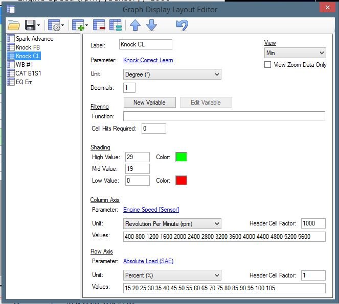

    What does the "CL" in knock CL mean? Closed loop? Something else?

    Those are user created labels. I've got custom tables I've created for logging to help me spead up my tuning and visualize whats happening/where it's happening. But the one you specifically asked about is from a Toyota Enhanced PID for the knock correction learned value. It's essentially a fuel trim of knock, the higher the value the better (29 is peak, and the ECU starts at 21 in this instance). So if it drops below 21 I can adjust stuff to get knock back in check.
    My really cool one is for fueling. It gives me the amount I need to correct at any given cell based on my desired AFR/commanded AFR. :D
    Here's that table. They're totally customization and configurable to allow you to see/interpret the data in anyway that helps you.
