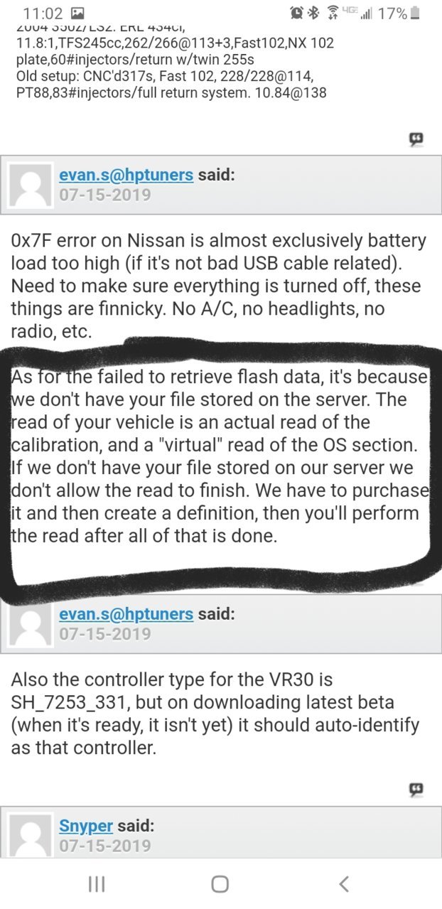

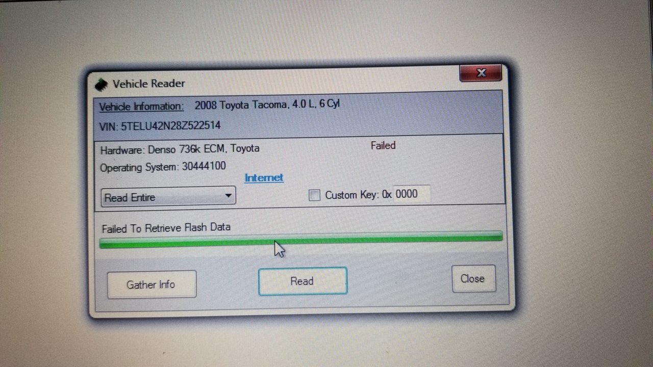

    Went to read for the first time and kept getting this message: unable to retrieve flash data.
    Found this on a quick google search. 20191115_224608.jpg Screenshot_20191115-230255_Chrome.jpg

    Is your key in the ON position?

    Yeah key on, battery charged.

    Good internet connection?

    Yeah. Tried my wifi and mobile hotspot. Both work and are strong.
    In searching google and talking with justin, and I quote from the master himself "
    It appears some of the first production years seem to have a random calibration that they missed when adding support.
    It's been a quick fix in the one instance I had with the guy and his 2007. It was the weekend when we had issues and they had it sorted out Monday or Tuesday." So looks like it's not going to he a huge problem. :annoyed:I already submitted a ticket with HPTuner .

    I was just going to mention about some cals not being in HP’s data base and to summit a ticket. HP will take care of you!
