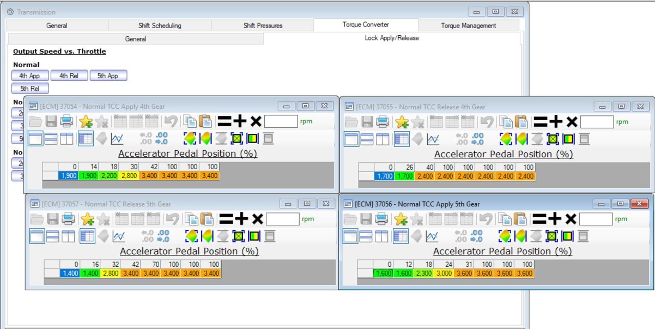

    are these "stock" numbers for the 4.0L? mine seems to stay locked down to ~1100 with >0 throttle position, and I have the same nagging vibration that @Lthompson was referring to.

    Those numbers are Driveshaft output numbers not to be confused with engine rpms. So in 5th gear of a 0.72 ratio you are looking at ~ 1000 engine rpms with a driveshaft rpm of 1400 when the trans will unlock the torque converter at essentially no throttle input. The numbers pictured are stock

    Its an interesting way to go about thinking at first, but it makes sense as its the one constant as engine rpms change, rear gear options can change etc. But driveshaft output stays the same and only changes in 4low.
    As someone who has delved into the auto trans tuning quite a bit (if you go back to the top of this page, post #4861, you can grab my latest "v12" auto trans tuning excel doc and have a look at everything). Feel free to ask any and all questions!
