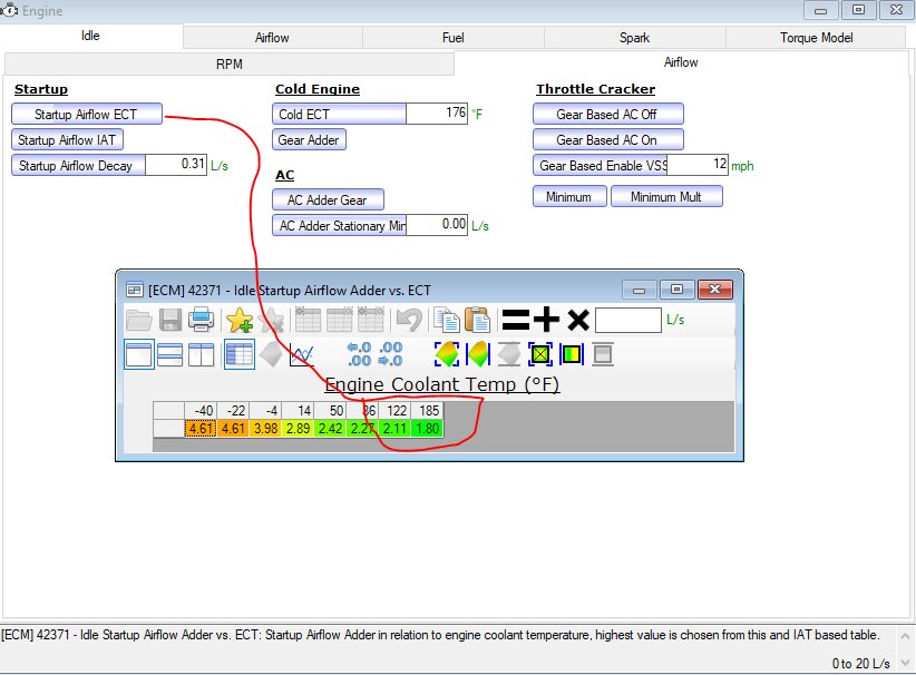

  15. Nov 27, 2019 at 3:39 PM
    #4895
    loginfailed
    loginfailed Well-Known Member
    Aug 29, 2016
    #195923
    5,156
    Dwayne
    Houston, TX
    2014 DCSB 4WD
    Moved over from the other thread to more appropriate thread.
    @BillDaCat8 @JustDSM
    I found this table and these are the stock values. If this is to be believed, then closed loop is enabled at considerably lower temp than thermostat regulating temp. Need to dig more, but this is a start.
    JustDSM likes this.

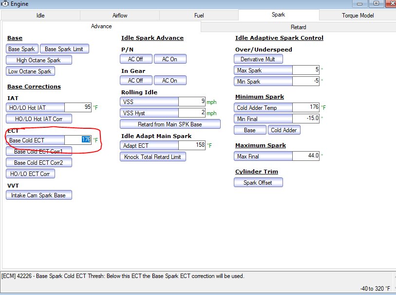

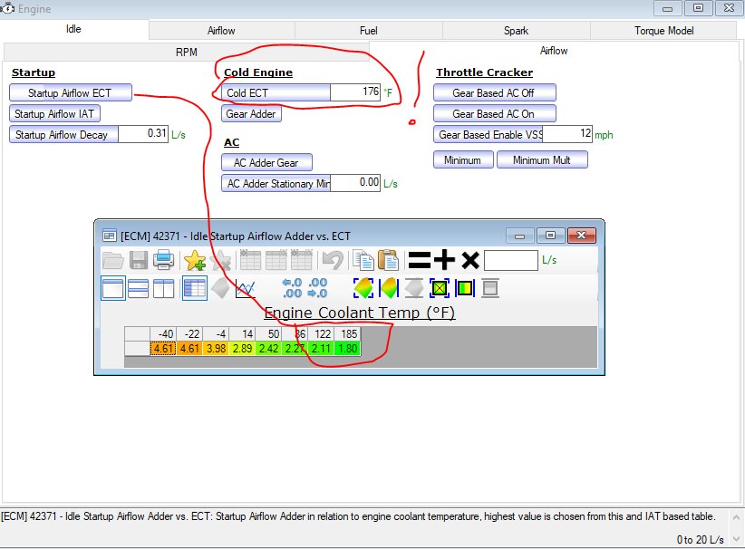

  16. Nov 27, 2019 at 6:16 PM
    #4896
    BillDaCat8
    BillDaCat8 Well-Known Member
    Jun 25, 2017
    #222348
    1,919
    Jake
    PHX
    07 4x4 Access Cab M/T
    My shit is all stock.
    Referencing closed/open-loop was a short cut I took this afternoon while typing one handed (Patty melt in the other hand) on my phone during my lunch break.
    There are many adjustments that need to happen to do this temp change right. Some may not even be defined (yet) in VCM editor. I found yet another whilst perusing tonight.
    The throttle learning is another that I know will not work until 176 degrees. I can't seem to find an adjustment for that though. That may not yet be a defined adjustment yet.
    JustDSM and loginfailed[QUOTED] like this.
