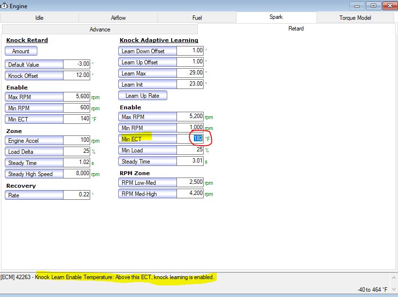

    I just finished going through every table and made adjustments to some of the relevant ECT related tables.
    Some of the drop down ECT fields do not matter since their associated tables are either all zeroed out or the referenced tables contain values in the columns that would not make a difference if the drop down for ECT was lowered 10-20 degrees or left alone.
    There are probably a lot of tables not defined, likely to include one that defines the strategy for P0128.

    Sounds like you got it worked out. I believe just about everything is defined to address the running the motor below standard ECT's. @Roostfactor also runs that in the 160's/170's as I recall and he hasn't had P0128. Keep us/me posted if your corrections don't work out.

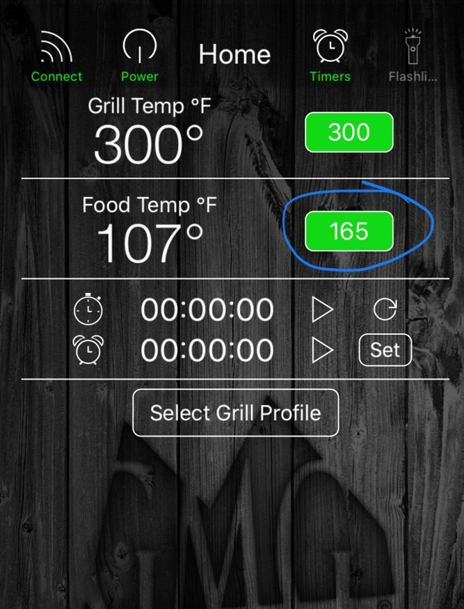

    My shit is all stock.
    It would certainly appear so.
    I've got my turkey on the smoker set to 165* as I type this. Coincidence?.... yeah...
    Happy Turkey Day Everyone!!!!
