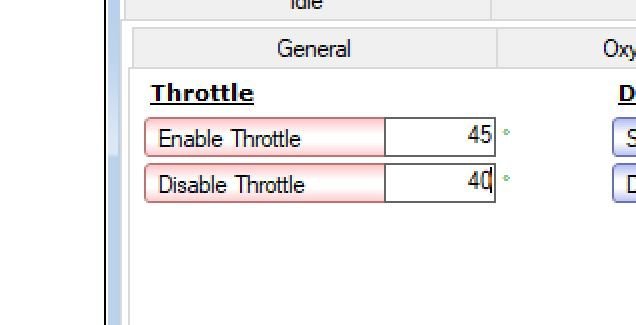

    I’d like to put it out there that adjusting this table here makes the ECU go into power enrichment as early as you’d like.
    Figure out when you’d like it to go from closed loop to open loop and make it happen. It makes the stock ECU behave very much like the UCON does (with regards to power enrichment happening earlier).
    I’ve seen it said several times something to the effect of “That’s the beauty of the UCON, it’s always operating in open loop”. Well, I’m here to tell you, the stock ECU can do it too. No more part throttle lean issues!
    Stock setting is 75 enable, 70 disable. I currently have it set at 15 and 10. It goes into power enrichment very easily! Now this is not a magic wand. You still have to make other adjustments as you’d expect. But this setting is a game changer. Especially for guys with smaller pulleys, where boost happens a lot earlier than with the stock pulley.
