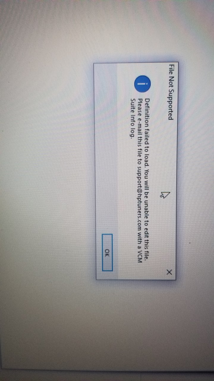

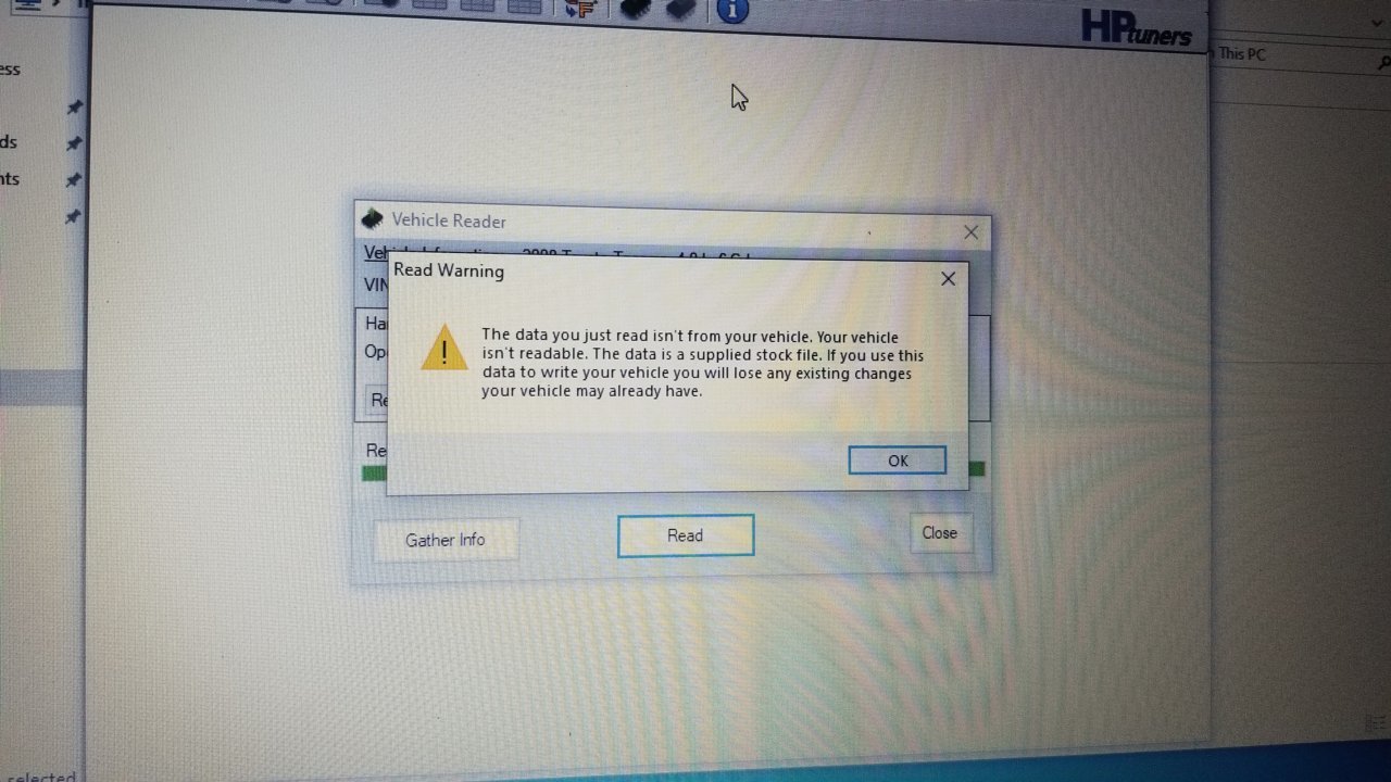

    ebuyaer2002
    ebuyaer2002 Well-Known Member
    Apr 13, 2018
    #250362
    155
    Nate
    Salem, OR
    08 Tacoma TRD OR DCSB 6 Speed
    RC 6" lift, icon coilovers, DK uppers, URD intake, DT Longtube Headers, Cam gears, 70mm throttle body, Custom Tuned with HPTuners
    Made it a little closer. Was able to read and download the read. Then kept getting this error message when I try to open it. Sent what I was able to download to Justin in Hopes he can sprinkle some magic that I so desperately need. 20191205_200935.jpg

    JustDSM
    JustDSM Oderint Dum Metuant
    Jan 16, 2015
    #146525
    3,320
    Justin
    Ogden, UT
    What order did those appear? Looks like the tune file is downloaded (The second image you posted is the "Virtual Read" notice and is 100% normal). But the first image is no-Bueno. That's going to require @HPTuners to address. I've noticed a few of the newer vehicles they've released support for (Subaru specifically) show the same definition error. Give them a shout (again..) and let them know that you're experiencing that error.
    Double check that your using the latest Beta (at least the version they suggested earlier or later).
    If you'd like, email me the stock calibration file that you downloaded (file with .hpt extension) and as soon as the definition is corrected, I'll whip up the tune with a little secret sauce and get it back to you ASAP.
