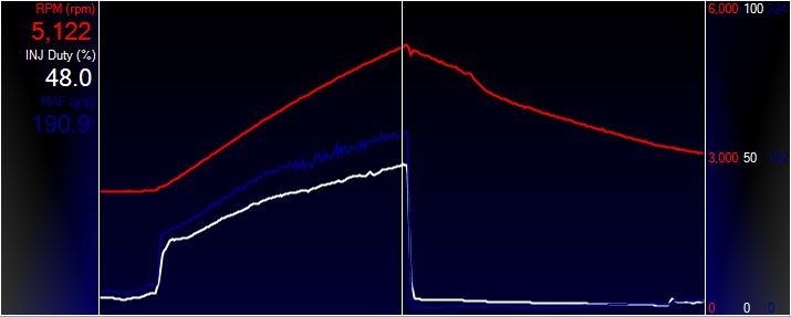

    This is about 2 months back, we were still in some pretty warm weather. I typically see around 195g/sec but that's not going to change IPW much.

    That's wild. A reduction of half the overall IDC over the NA injectors. Very nice! :thumbsup:

    @JustDSM howd you find your idle. Ive always had the understanding that at WOT you want you idc in the highest third to give you optimal control over WOT trim and prevent lazyness/poor trim when at the lower currents in the low air speed situations. 100-200cc isnt a huge jump obviously but as your aware 1% idc in a 30lber to say a bosch 210 is a bit.
    Seems happy with the bump up?

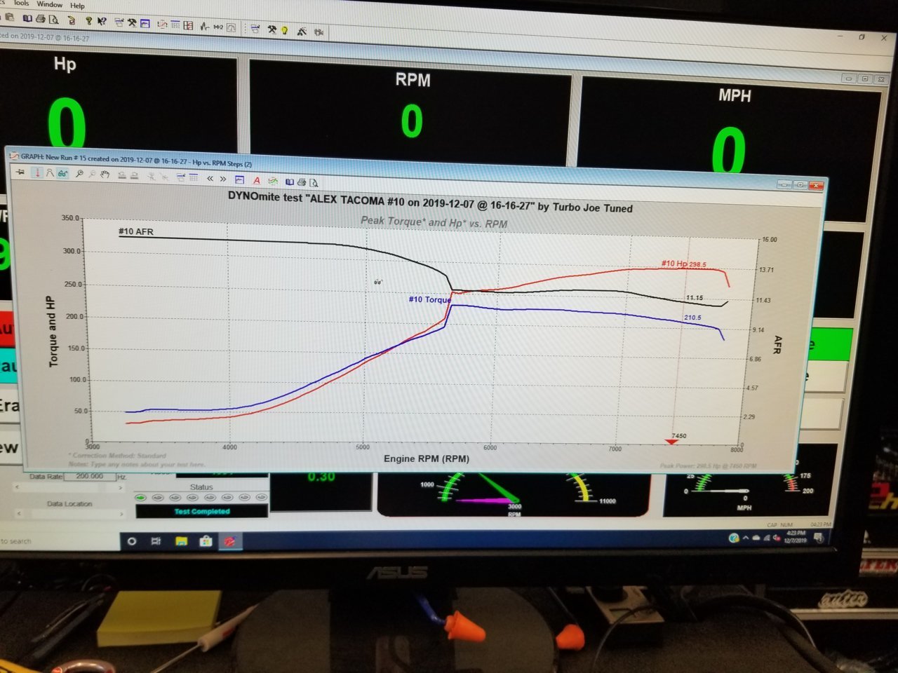

    Just pulled 298hp and 213ft lbs

    Mods?

    Supercharger, trd cat back exhaust

    Those are rookie numbers. We gotta pump those numbers up.

    Someone pulling more with same mods?

    No not really, those are expected numbers from those mods (or lack of blower mods) but once you start stepping down pulley sizes and start getting and doing more supporting mods for the blower you will find those numbers start climbing north quite nicely and the butt dyno will thank you as well.

    Running 93 on those pulls?

    I’m more interested in the fact that did they actually rev your engine to 7,000 rpms??

    Yeah, as stated before, why such high RPM?

    Very weird looking graph...

    Yeah, torque seems low as well.

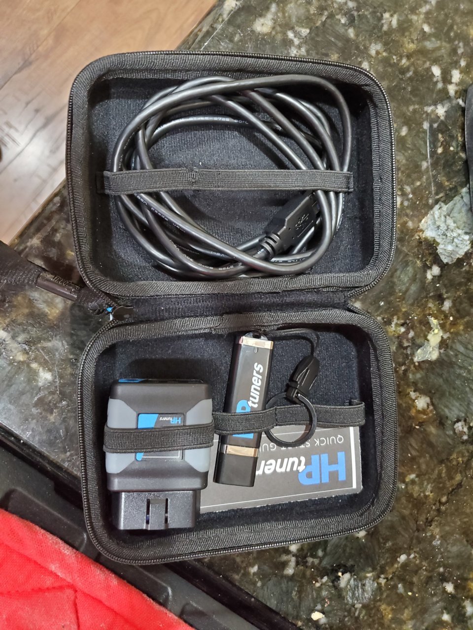

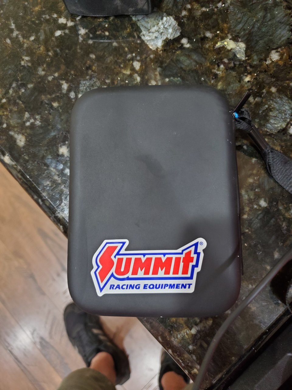

    I found almost the exact same thing I had laying around. It was a case that had a portable battery charger for phones. This will be a much better use for it. 20191208_132132.jpg 20191208_132141.jpg

    That’ll work perfect!

    I’d be careful with bumping up your rev limiter to 7.4k on stock internals. Even with a forge build I don’t think @Torspd has his set to 7k.

    This dyno graph:popcorn:

    The more I look at it the more it doesn't make any sense. If it was at a 14 AFR up to 5500 rpm yikes. That poor motor isn't gonna last very long..

    Yeah. URD and rotrex have been over 400 rwhp for sometime now. The torque curves on those are weak sauce though. Regardless, HPtuning is exciting!! I’m hoping to get a hptune once I get a new clutch.
