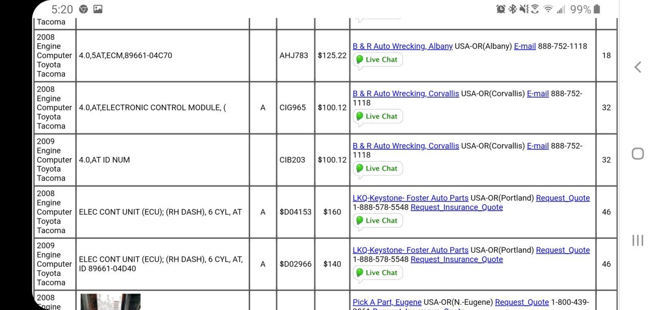

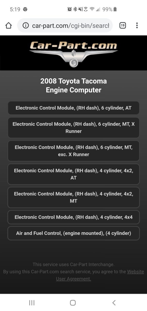

    Screenshot_20191212-052043_Chrome.jpg These are local to me on car-part.com. I'd be happy to pick one up and ship it out to you if end up needing it.
