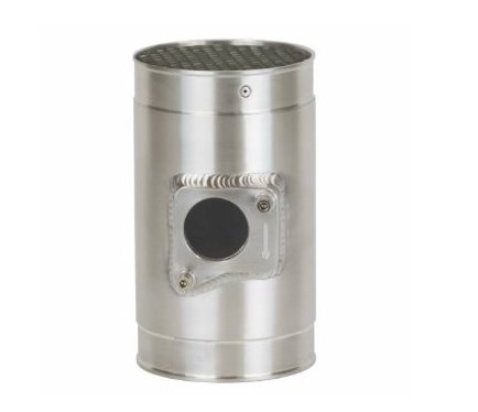

    Does APR still sell them outside of the UCON kit?
  20. Apr 8, 2019 at 1:37 PM
    #520
    JustDSM
    JustDSM Oderint Dum Metuant
    Jan 16, 2015
    #146525
    3,311
    Justin
    Ogden, UT
    These are a possibility.. :D
