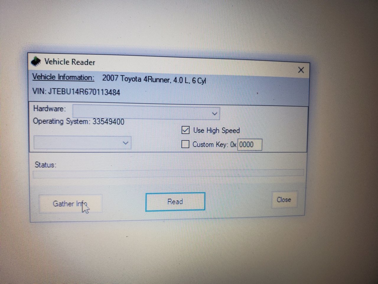

    I tried to read my buddys 4.0 2007 4runner today for shits. It was not successful.

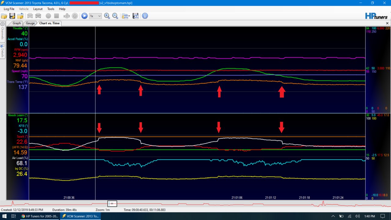

    That datalog complements my dyno, with it in normal operation, and then locked in either direction. Without a s/c, the effects are drastically noticed even by the seat of the pants.
    DesertRatliff and JustDSM like this.
