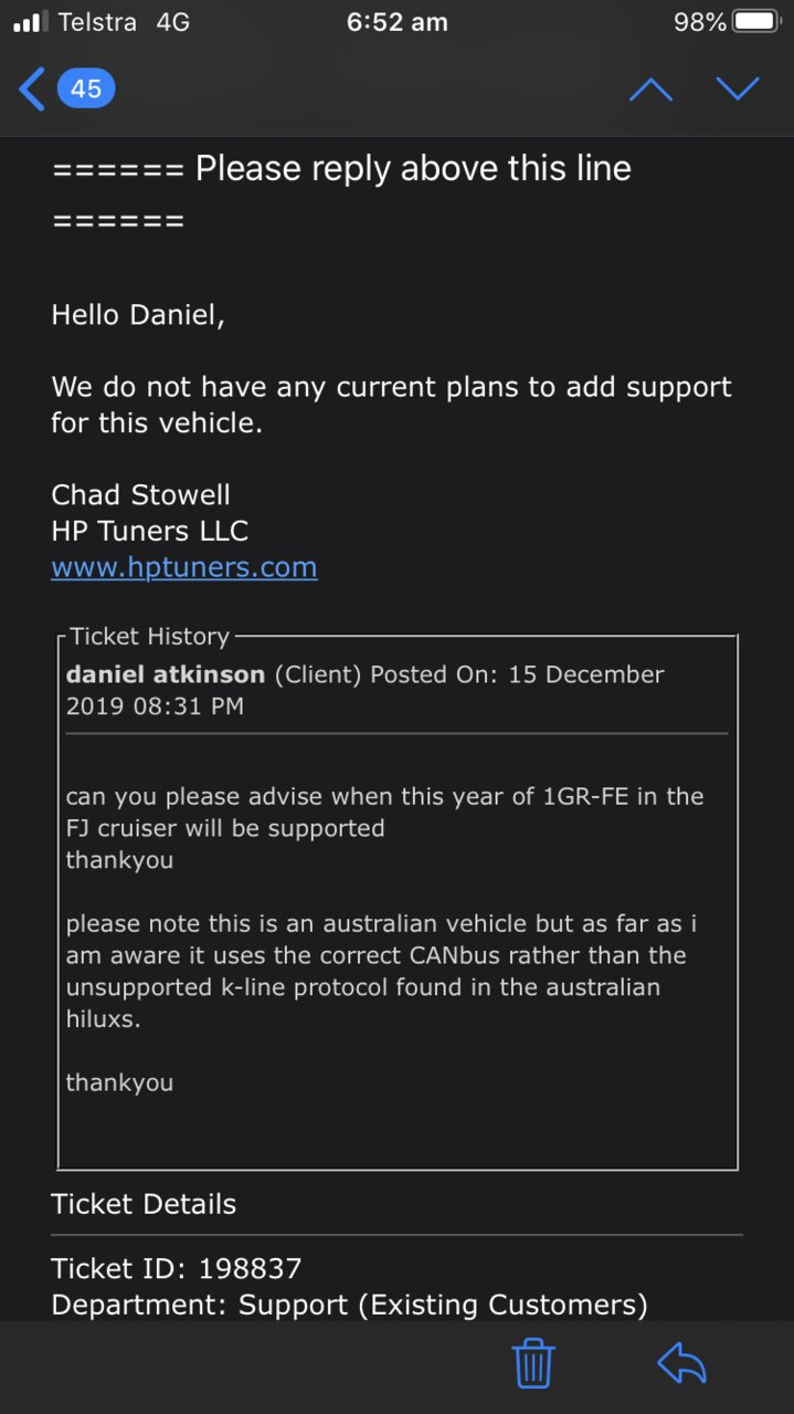

    Au1gr
    Au1gr Well-Known Member
    Nov 30, 2019
    #312153
    140
    Daniel
    Perth, AUS
    2012 audm FJ cruiser. Cant see ANY differences apart from the steering wheel on the otherside.
    from what i can see its just that small portion that are TRD compatible getting support
    pre-09

    OVTune
    OVTune Well-Known Member
    Mar 27, 2017
    #214557
    8,112
    OVTune
    Australia got the short end from Toyota. Even the brand new Lexus vehicles being sold over there are STILL K line.
    You cannot even adequately data log with that acient communication protocol
