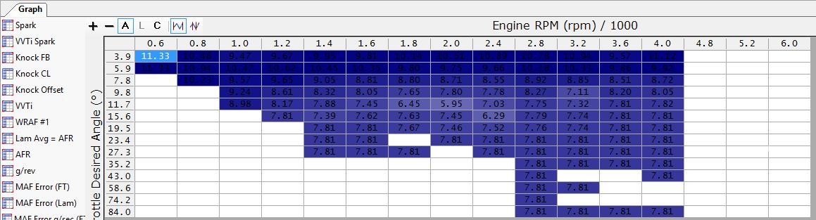

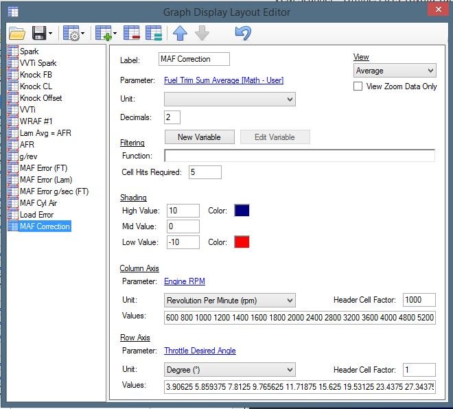

    You can use previous data.
    Open the log, create graph, and the data will auto-populate based off your parameters.
    **So long as the necessary PIDs were logged originally**

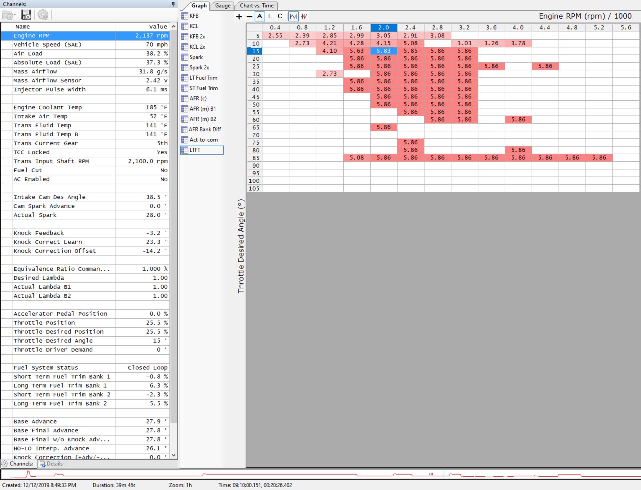

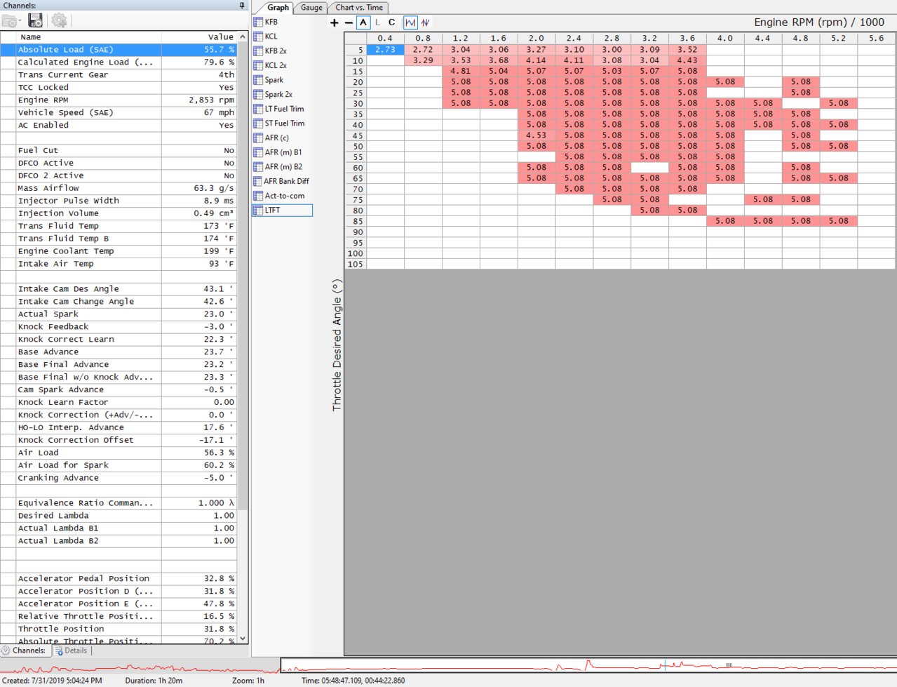

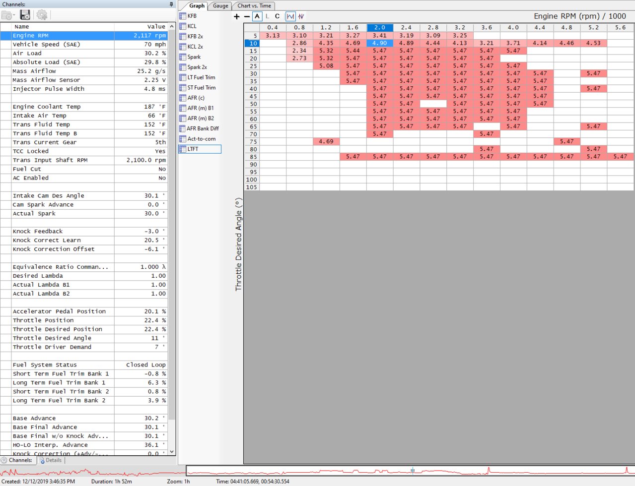

    I definitely get what you guys are putting down. Intake is stock with an intake manifold spacer (which shouldn't matter for maf readings as its after the maf). While yes there are some minor variances in LTFT's at different rpms / loads, they tend to be on the extremes of low throttle or low rpm, but the bulk as you see are all VERY similar. (from long duration logs, 3 different times all with similar PE and COT fueling, cells graphed on a LTFT B1 + LTFT B2 / 2 math).
    But I could totally see using the 3d table to fine tune things like you guys have suggested as if you look at the amount of hits in those cells and there is lots of time spent in ones that arent the same! I shall look into it!
    EDIT - graphs pictured were just quickly generated, going to look into this more and mimick axis values in actual tune 3d chart and go from there.

    can you show us the trims from each bank.
    if one bank is needing considerable more enrichment (or less), you might want to look elsewhere first (plugs, injectors..possibly adjust fueling based on cylinder).. however 5% LTs is really nothing to be worried about generally, and you'll never get 0 all the time.

    They usually hover around bank 1 typically needing 2ish% more than bank 2.
    Oh i know im never going to see LTFT's of zero, but figured if i could optimize the tune a smidge why not.
    EDIT- Its my understanding that LTFT's will really only effect fueling outside of measurable commanded range by the O2 sensors, IE open loop, or deeper in the low AFR's of OL drive?
