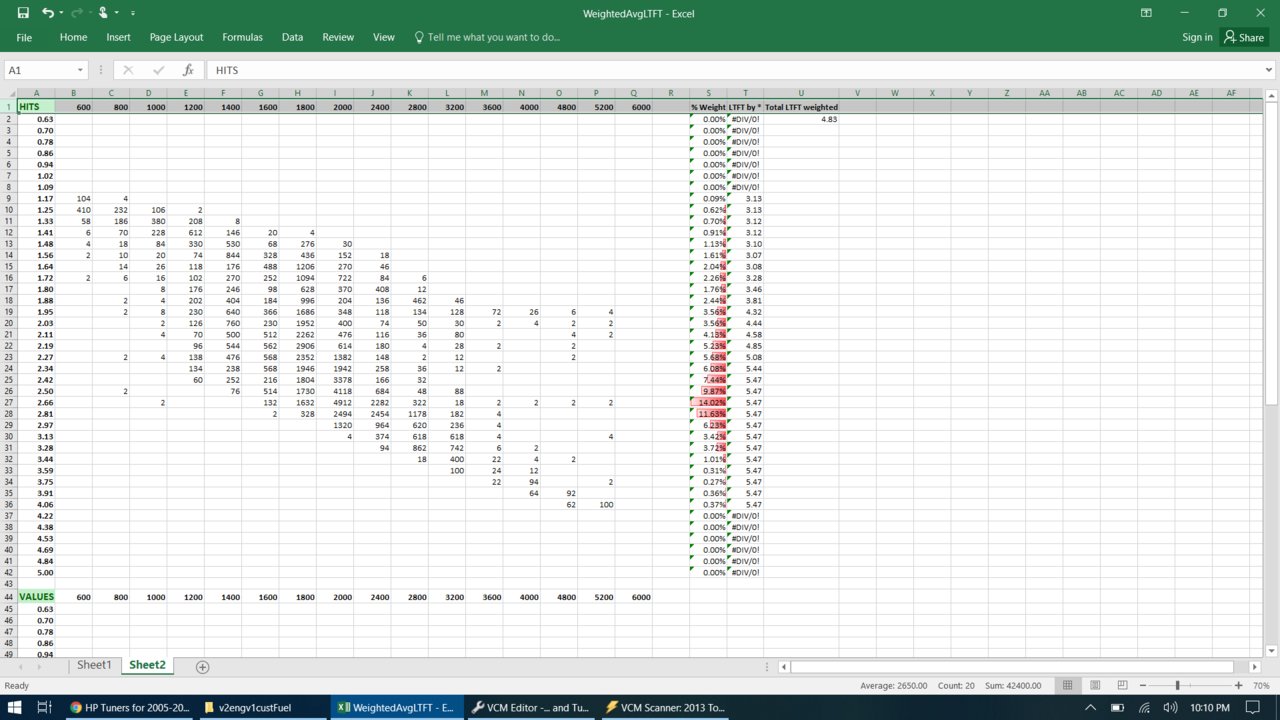

    Colder plugs, interesting thought. I honestly doubt that they are a source of detonation on an NA motor... but that stated I dont think that anyone has tested the theory.
    As far as LTFT's i bumped allll of the maf to volts numbers up by 4% based on logs which have gotten LTFT's down closer to 0 (down from 7ish% to 3ish% positive). But I am doing some more and more logging with some more "refined" logic and data manipulation. Excel doc, weighted averages based on axis values of the main 2d volts to lb/h table and rpms of the main maf correction table (just cus its easy). Thought process being, start with a gross number (IE 4% across the board) see where things need to be changed on the 2d graph. THEN ill move over to the 3d graph for final refinement ... if i get that far.
    Fueling on bank's is interesting as mentioned before. under 10* throttle angle, bank 2 requests ~5% more fuel than bank 1, at 10*+ the LTFT's are about even and actually flip wherin bank 1 requests ~1-1.5% more fuel than bank 2
