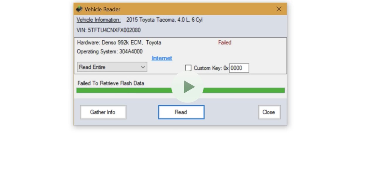

    74
    yes i saw this ticket. the problem here is we don't have the stock file and since Toyota has never released an update for this calibration we will need to purchase a PCM and get it the hard way. Once my colleague has ordered a PCM he will likely respond. Sorry but this is a problem with all Toyota that cannot be read unfortunately.

    OVTune
    What's the cal ID, I've got nearly all of them, if it can be submitted to HP Tuners as bin file

    I tried .499 and .500. I see you are now at .502. I will test shortly. Thank you for the support!

    Matt, see below.
    304A4000

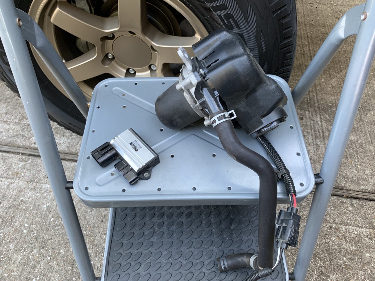

  16. Apr 8, 2019 at 4:25 PM

    JustDSM
    JustDSM Oderint Dum Metuant
    Jan 16, 2015
    #146525
    3,262
    Justin
    Ogden, UT
    <3

    More room for a @Torspd turbo kit.

    Damn I want to get rid of my vacuum cleaner too.

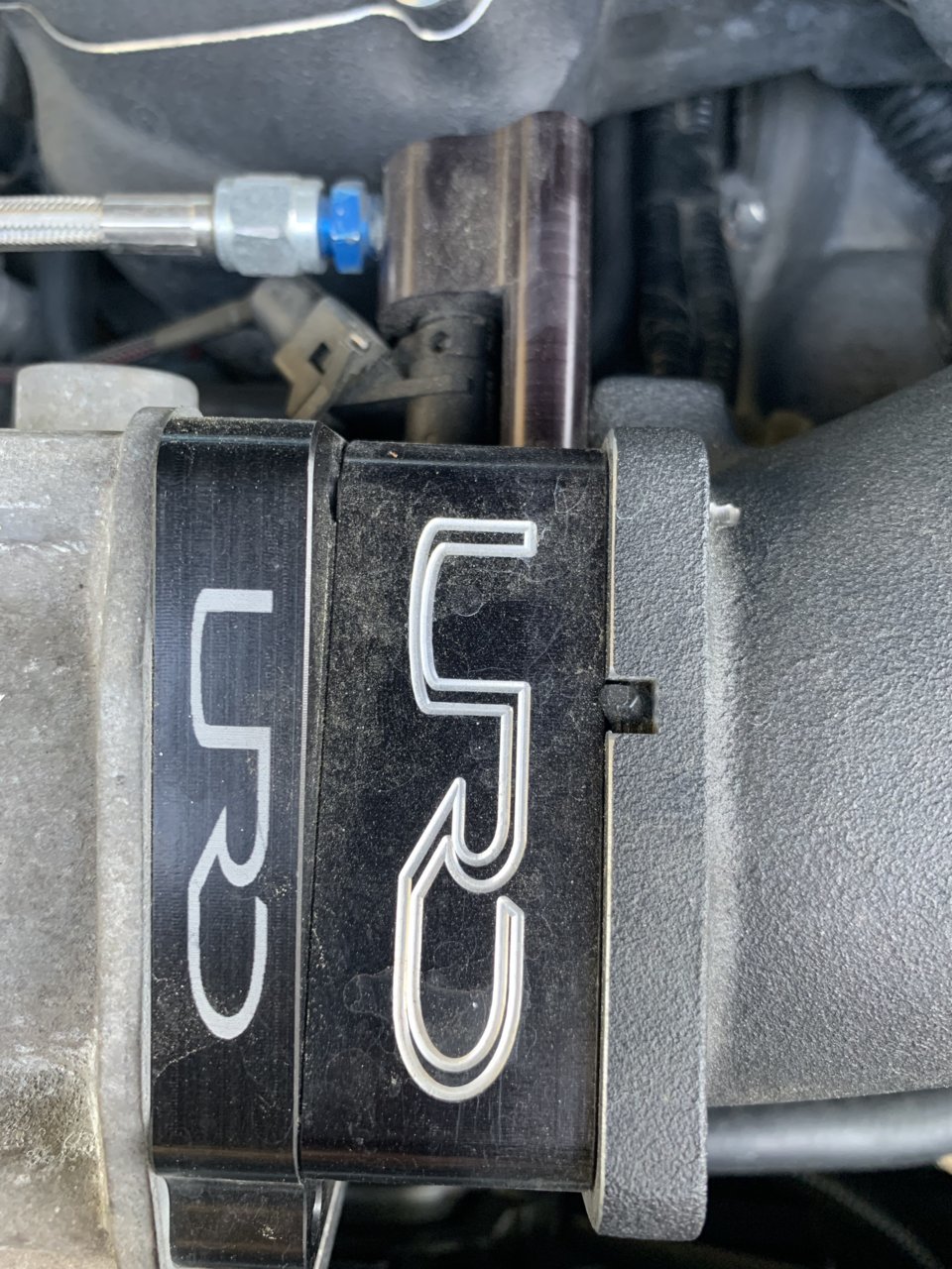

    #539
    loginfailed
    loginfailed Well-Known Member
    Aug 29, 2016
    #195923
    5,156
    Dwayne
    Houston, TX
    2014 DCSB 4WD
