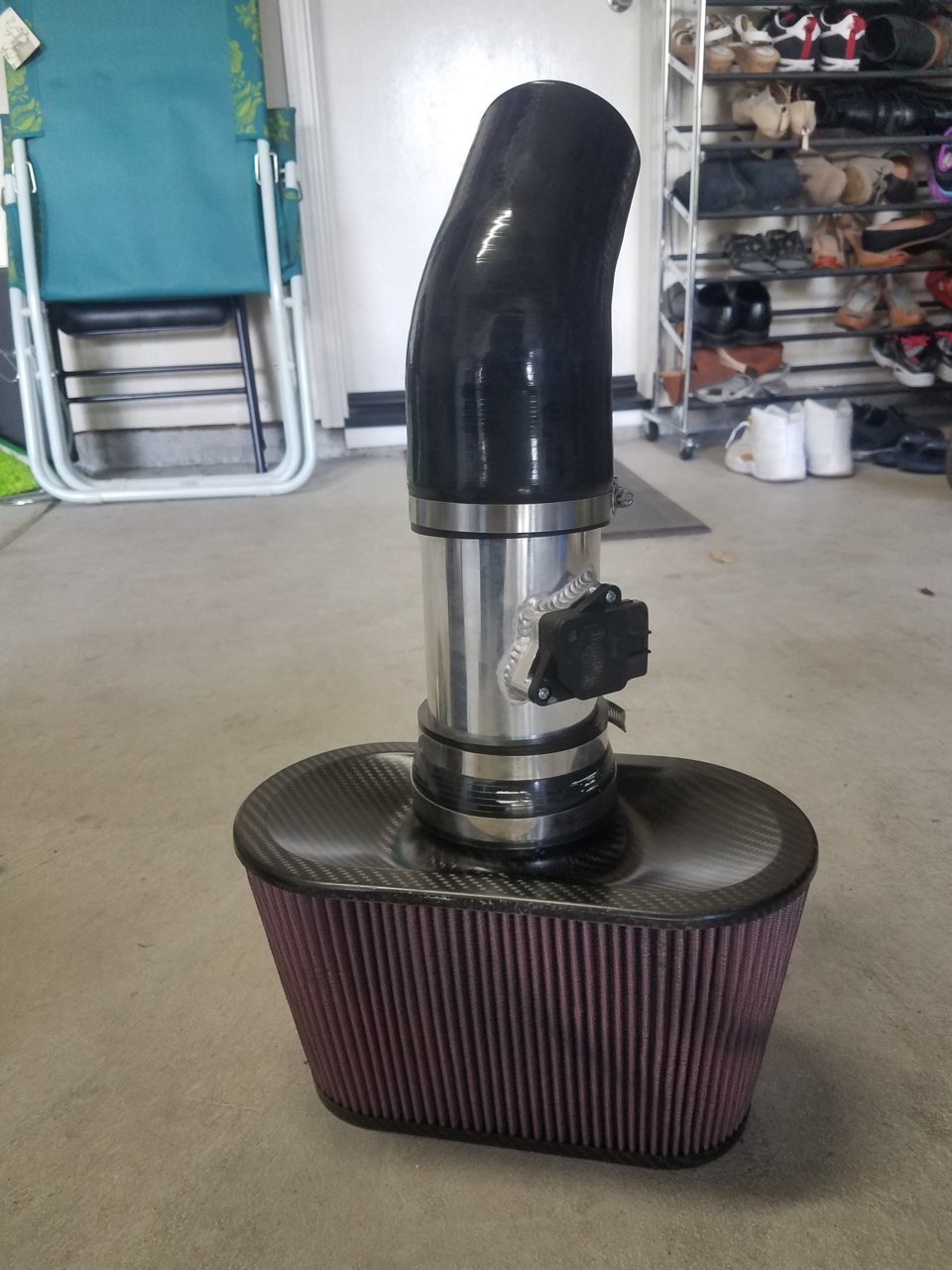

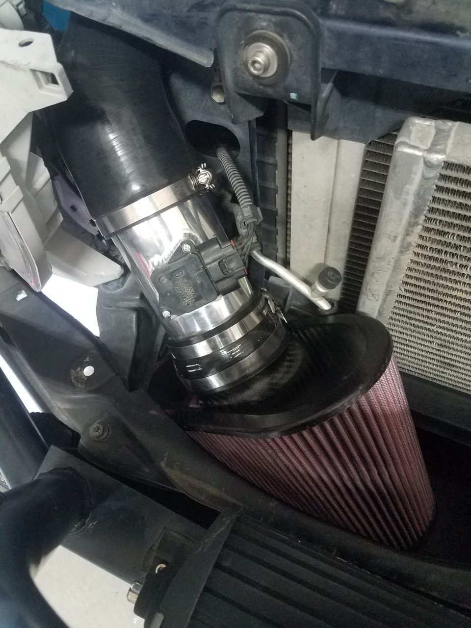

    Okay so I'm officially revisiting the 3.5 intake tube mod again. I got a 3.5 MAF adapter with an integrated honeycomb straightener integrated into it, an AEM Dryflow 3.5 filter in black, and a 3.5 to 3" silicone 45* elbow... I will let y'all know when the parts begin rolling in. Excited to finally put some of this whole "running out of MAF GM/S" thing to rest.

    Got a link that talks more about this? New to me curious a about this mod. =)

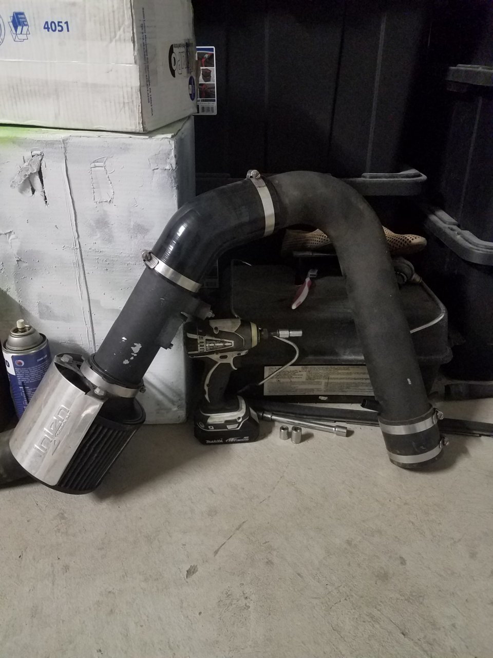

    It's a mod within a mod. I am using the URD ram air intake and am running out of MAF headway on the 3 inch tubing. The MAF tops out so some weird stuff is happening to the running condition of the truck under boost. I thought we'd be good with re-scaling the MAF but come to find out the truck is still knocking under various instances. Changing the tube diameter from 3 to 3.5" at the MAF shortly before the intial bend of the intake occurs and then going back to the 3" tubing will take care of the additional airflow that the 2.3 pulley creates and will fix my knocking under certain instance load issues I've been having.
    This was the setup I was going to run. This was prior to HP Tuners, however, and I gave up on the project as I didn't anticipate the change in tube diameter size would make the truck run so horrible without tuning.

    ah fun times! I guess we will see how it goes.

    See edit to quote.
