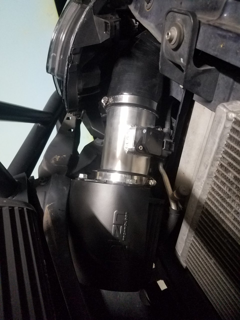

    Just installed my 3.5" intake/ MAF adapter/ 45* elbow assembly tonight. Took it for a spin using some baseline scaled MAF values @JustDSM had made for @mightytacoman some time back. My thoughts...
    - General putting around town feels peppier and highway inclines feel less "strained" for lack of better words, the truck just wants to go now
    - Boost numbers are back up again from the initial 1.5psi gain the intake netted me. I went from pretty nominal numbers of 11.5-11.8 psi at WOT with the 3 inch intake setup to a new 12.6-12.8 psi at WOT REGULARLY.
    - After reviewing the datalogging I had done for Justin earlier tonight I found a maximum MAF grams/sec to be no more than 301 or 39.77 lbs/ min. this is well below the previous top out maximums of 341.7 grams/ sec which the 3" intake/ MAF adapter/ 45* elbow was getting me, granted those numbers were what I found doing a very brief skim through of maximum top out values, so they may be higher, Justin will know after reviewing said data.
    I must say, just off a singular baseline setup running my 2.3 pulley, I am INCREDIBLY happy thus far with the results of increasing intake size by just .5 inches. Crazy how held back the truck has been all this time simply because of that. It makes me wish that I switched over to a 3.5" setup sooner after the inauguration of HPT for these trucks! I am highly impressed, and while there is no doubt some tweaking which must be made to fueling to get all of my stuff correct in the right general range which I'd like to be in, I really am liking the results so far. Especially with the newly found boost! Something tells me this thing will be a 13 psi peak pulley after all!

    @12TRDTacoma Would love to see pics of your intake if you've got some. Thanks!

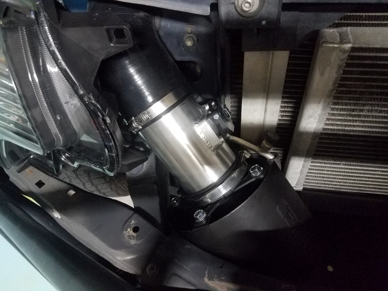

    These were quick and dirty shots I took of it last night after setting it up. I may remove the MAF adapter and give it a few shots of black spray so it's a little more hidden back there.

    Where'd you source the maf adaptor? Been meaning to do this for a while.
  14. Jan 7, 2020 at 9:10 AM
    #5454
    zippsub9
    zippsub9 Well-Known Member
    Nov 3, 2014
    #141634
    4,565
    Halfmoon, NY
    14 DCLB
    Shit bolted onto other shit, and junk.
    Spectre carries a ton of this stuff.

  16. Jan 7, 2020 at 9:28 AM

  17. Jan 7, 2020 at 9:37 AM

    From my reading, as long as you have 2x diameter, straightline distance prior to the MAF then the "straightener" honeycomb shouldn't be necessary.

    Well the Honeycomb was optional but I just wanted to get it done and out of the way and rule it out as a potential airflow reading issue.
    It was more of a prevention thing to me more than anything. Plus I like the bling bling factor. ;)
