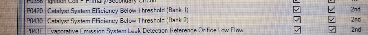

    RC 6" lift, icon coilovers, DK uppers, URD intake, DT Longtube Headers, Cam gears, 70mm throttle body, Custom Tuned with HPTuners
    Can someone give me a hand? I installed headers and am trying to get my downstream o2 sensor check engine light from coming on. I found the ones the ones to delete, but insure if I am supposed to uncheck both boxes and if the mil on optioknshould be 1st or 2nd. Also if anyone has some tips on how to make the rpms drop a little faster between shifts (6 speed).
    The p0420 and p0430 are the ones I'm after

    I believe one check box is for the MIL and another is for the Systems readyness check via obd for SMOG. The 1st or 2nd is the option to trip the code on first or second occurrence of the issue. That settings wont come into play if both the checkboxes are unselected.

    Thanks for the reply @nd4spdbh Absolutely for off road use only. So just uncheck both boxes and good to go?

    Yes

    I will send you a full list of the codes in about twenty minutes. It is more than just a few boxes.
