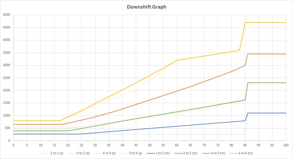

    What @HPTuners needs to do is bring out tables which allows the tranny better downshift capabilities under uphill or incline situations. The tranny lugs too much in the same gear for too long before downshifting.
    I'm surprised the issue still has not been addressed actually!

    That can all be changed currently. My v12 trans tune is based around my essentially stock NA truck with light tires so a SD'd truck with heavy tires and armor is going to change things.
    Downshift curves on my v12tune have not changed much at all:
    We could easily create downshift curves that are raised up for "quicker into the pedal" downshifting.
  20. Jan 8, 2020 at 9:29 AM

    What, really?! Oh well hell, I stand corrected then. I had no idea.
    Hey @JustDSM has his v12 trans tune been integrated into my latest tunes by the way? I definitely want to take advantage of that fast downshift based on incline stuff.
