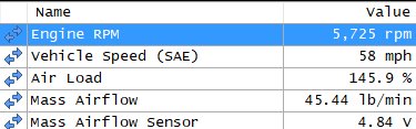

    From my most recent log, I am up from the previous 42.83 lbs/ min or 341.7 gm/ sec at WOT that 3" intake configurations allow. I am quite pleased with the added change which the 3.5 intake allows.
    Yes throttle % max out is at 81.2.

    FYI, if you use "Accelerator Pedal Position" you will get a proper 0-100% reading.

    Oh I just use the basic layout which was sent to me by Justin. I don't really monkey with the tables and when it comes to toying with this stuff I am a total amateur. Hahaha. I am not super PC saavy enough to know how to change things around like that.

    So VCM Scanner you have channels you record (the ones that Justin has sent you) and then have graphs, gauges, chart vs time that are based on those channels that are being recorded.
    If you would like some cool gauges / graphs / charts vs time let me know and I can send you my setup.

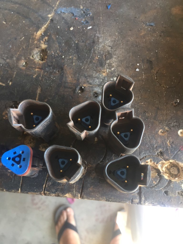

    Any one with a bench harness actually put resistors in there canhi canlo circuit?

    Ogden, UT
    120ohm

    Yeah i stole some out if a cat haul truck.
    Nice molded deutch plug jobbys. But did u actually put them in? Ive made bench harness’s for caterpiller stuff with straight twin core from the service tool the the ecu and no dramas

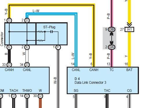

    Is there a resistor in the taco schematic?

    There is. The location depends on the year. 2005 for example has the resistors [they use a low pass filter (capacitor to ground) to remove noise] one on hi and the other on low terminating to the capacitor as part of specific connector. 2015 on the other hand has that exact setup as part of the cluster.

    Perth, AUS
    You ran them through to a ground or buffer between hi and lo like i guess a traditional Canbus circuit is
  18. Jan 8, 2020 at 5:24 PM
    #5518
    JustDSM
    JustDSM Oderint Dum Metuant
    Jan 16, 2015
    #146525
    3,262
    Justin
    Ogden, UT
    I didn't ground them. They do in the OEM harness though.
