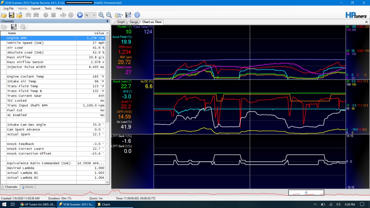

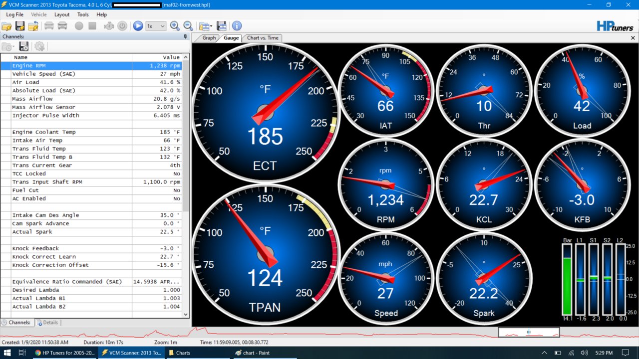

    So these are the gauges and charts i use. Keep in mind you will need to be recording the channels that they require. Anything with load i used the "Absolute load SAE" over air load.... so thats easily changed if you are using JustDSM's channels. I use his + some more.
