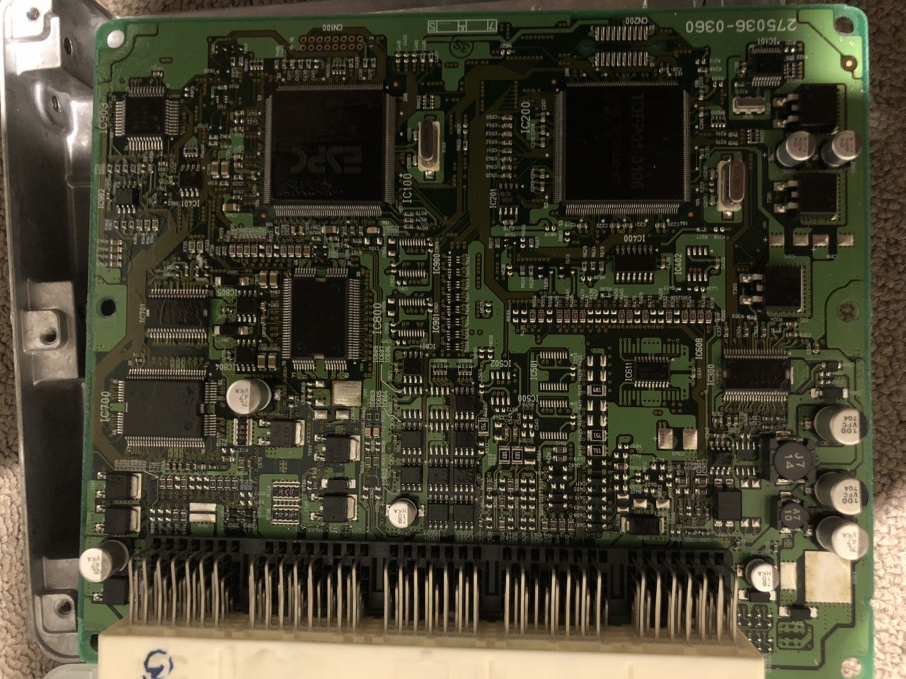

    open the ECU and take a high res pic of the board I'll point it out.

    opening up the box now

    That was my thought when I thought you had 2 ecus wired in. If the tacoma is not getting any message back from the security module, then it will kill the engine. How it works is there is a chip on the ECU that stores a unique string of hex, The ECU verifys this hex string vs the security modules response, and will keep the engine running.
