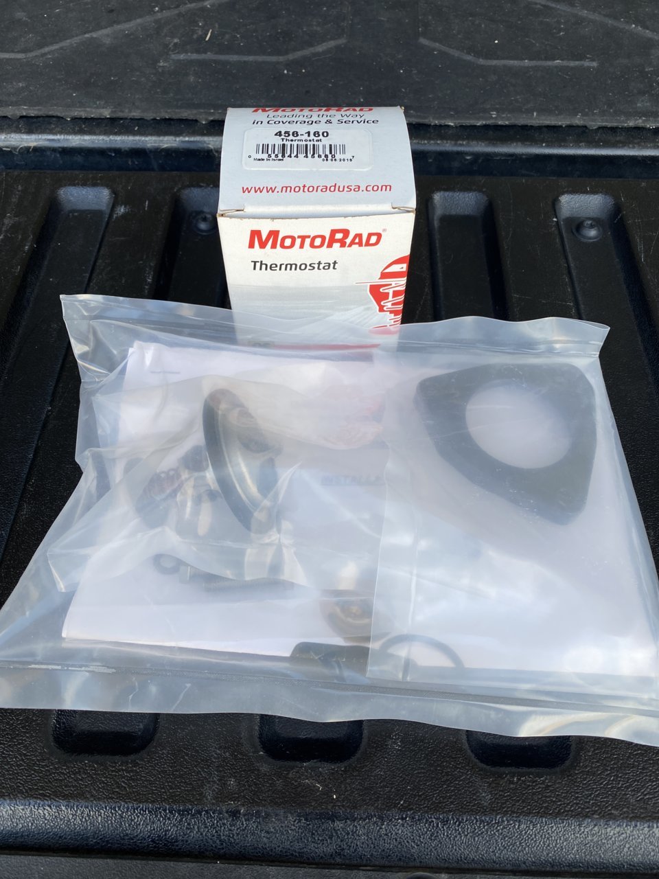

    Just about to call it quits for awhile with performance mods and pay some attention to the rear suspension. For now, I've got intake, headers, 70mm throttle body, and cam gears, and an amazing tune from @JustDSM . Question is, would a 170 thermostat from URD Benefit me at all? Not trying to push and limits, but was curious if anyone has seen any benefit with tuning after the cooler tstat.

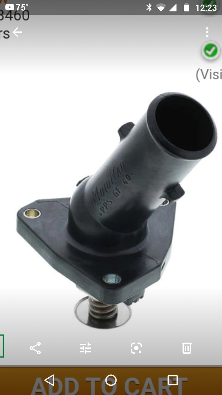

    Also, came across this 160 deg direct replacement. https://www.autozone.com/cooling-he.../duralast-kit-water-outlet/577311_656099_1640

    I do have a brand new URD 170° kit (and MotoRad 160° spare thermostat) that I’d let go for 25% off what they retail for if you want to give it a go.

    With the Motorad and URD adapter, it will work without tuning adjustments.
    With the Mishimoto, it flows better or opens sooner, and will need tuning adjustment.
    With the Duralast, I have no clue. Only one way to find out. Be interesting if on the t-stat itself, it had Motorad stamped into it.
    Norton likes this.

    As a matter of fact, it does. At about $20 cheaper than the Mishimoto! @$40.
    That is the cheapest one yet.

    Weren't any clear markings on my Mishimoto, as to manufacturer. Just to point out.
    Give it a shot and then some feedback.
