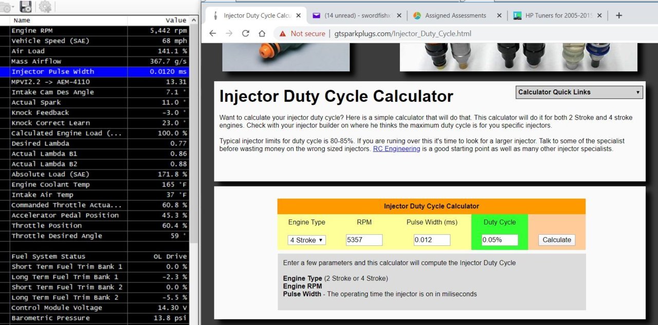

    Can Someone help my ignorant self out here? rpm 5442 and pulse width of 0.0120ms is what was logged but I have high doubts that I'm actually only at 0.05% duty cycle. How or what do I have to do differently to get my real duty cycle numbers?

    VCM Scanner has the maths built in. I can’t say what’s going on with that website you’re using, but you’re certainly above .05%

    The injector duty cycle is a function of the pulse width vs amount of time to do the pulse (which is based on RPMS). Those injector pulse width numbers are WAY low, almost seems like even though its stating ms its seconds.

    I didn’t even catch that! Good eye.

    I'll point it out to hptuners via a ticket. Somebody fumbled numbers putting that info in it seems. Thanks for the help guys!

    Yeah, if you put 12ms (.0120 seconds) into that calc you took a picture of you are at 54% IDC. Try changing the units on that channel to seconds then back to MS and see if that displays that properly. Also try and add the math in a chart vs time in hpt and it might work proper. (FYI that same online injector duty cycle calculates proper, with the figures at that freeze frame it calculates the same IDC as VCM scanner calculates)

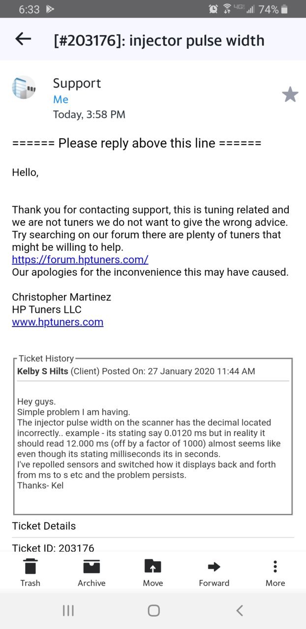

    Well hptuners thinks it's my fault that it's read wrong off of the ecm? Could that be?
    Response email screenshot attached. Screenshot_20200127-183315_Yahoo Mail.jpg
