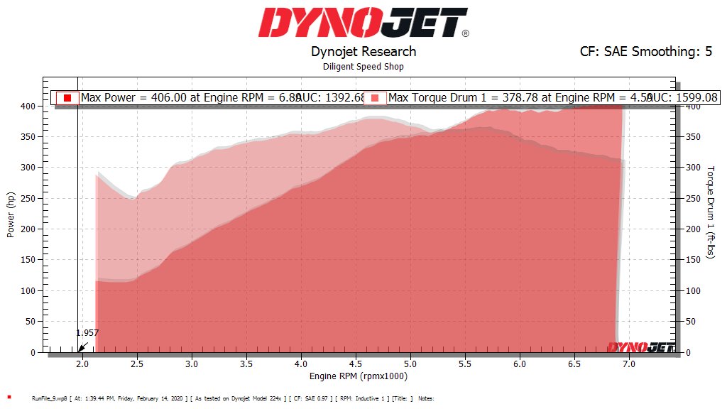

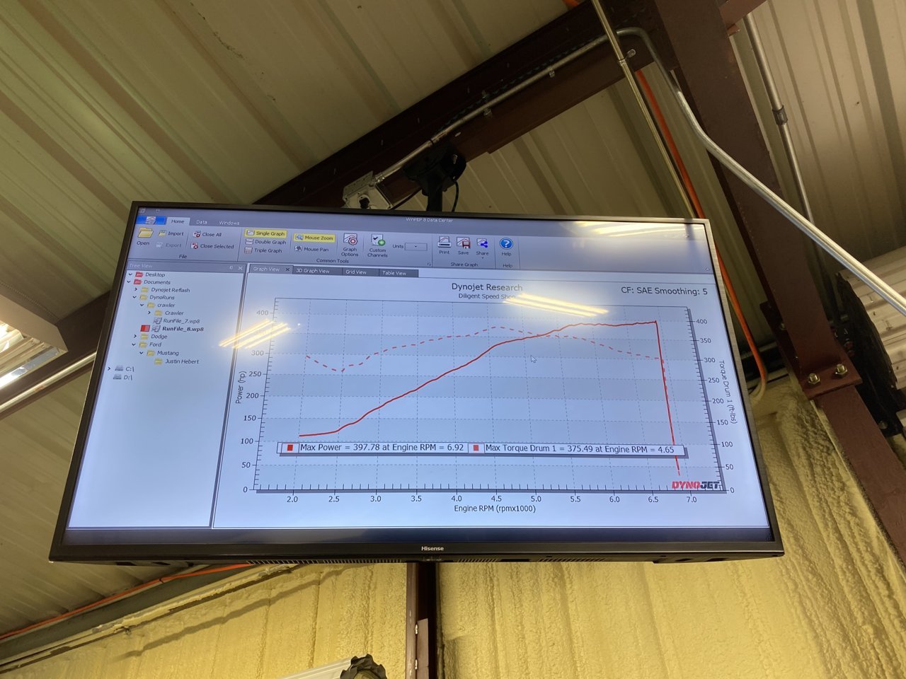

    Thought I'd share a little something with you guys who like the MAF g/sec readings.
    Had some free time today and did a little testing/baseline on my 5.0.
    220 miles on the ODO with whatever gas (87?) that the dealer filled it up with. 100% Stock tune:
    Run 1, Right off the street and out of stop-n-go traffic:
    2nd pull overlayed (Picked up a few, but I hate the graph layout)

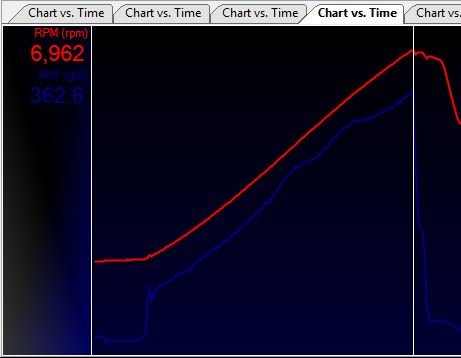

    Of course I datalogged :)
    The interesting thing.. 362.6 g/sec * 1.18 = 427.867hp
    The car should be ~460hp at the flywheel.
    We're seeing right between 13-15% drivetrain loss if the engine is making the advertised 460hp.
    Just a datapoint and something to ponder.
