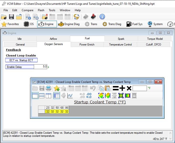

    @loginfailed do you remember what you figured out here? Just did the 160 deg thermostat last weekend and today I threw P0128 on the drive back from work
    loginfailed[QUOTED] and zippsub9 like this.

    P0128 TOYOTA Possible Causes Leaking or stuck open thermostat Low engine coolant level Insufficient warm up time Faulty engine coolant temperature sensor Engine coolant temperature sensor harness is open or shorted Engine coolant temperature sensor circuit poor electrical connection
    With the aid of HPtuners you can correct this code
    zippsub9 likes this.

    yup, you need to adjust the ECT temp from 80C down to 71C or so. I think there are two locations in the programming for it. There are certain adders that stay on prior to the ECT reaching the set temp.

    There are a few locations. Poke your head through all the tabs and find the ECT hot temps, there are a few around the 170* area and another at the 182*f i think that would likely need to be lowered.
    What are your temps with that tstat?

    Not sure what others running colder tstat's have set the "Hot" temps in the tune to. But id imagine a few deg under that (155?)

    Absolutely, I have today (it’s 2am) off work so I can dedicate some time for you.
    I know I spoke with one of you about known issues with the Mishimoto tstat, popping codes in @mightytacoman setup.
    There is likely stuff that is not yet currently defined that is at work here. What I’m getting at, is even setting everything to 160° does not immediately mean it’s “all good”.
    Regarding the extra timing, I did not add anything extra as I will typically use that increased knock threshold to expand/improve the safety net. That is, unless the end user wants a more aggressive tune and is willing to collect datalogs and go through a revision or two to get things dialed.

    The open/closed loop table we don't have access to I have narrowed down to being related to the COT temps. What the "trigger" is after temp conditions are met is still a complete mystery but we have an idea of where to beg hptuners to release the load tables we need.

    I haven't seen anything in the logs I've done that jumps out and says "yup- time for open loop" (in regards to the tables we already have access to) monitoring loads, pedal positron, timing, coolant temps, etc all seem irrelevant to kicking into OL. It could be a combination of two (or more) of those. Perhaps a preset table the ecm looks at and wants values within X% of or it will go into OL.
    Purly speculation. Perhaps @OVTune can shed some light on the tables he's found that can kick the trucks in or out of OL/CL that are related to COT protection.

    it's based on throttle position.
    below X throttle > demand stoic
    above X throttle > demand open loop
    open loop = calculation of all preset tables = fuel
    I don't know how or what tables are labeled what in HP Tuners
    There are also delay timers for OL / CL based on coolant temp, 02 heating, etc. I'd have to know exactly what scenario you're looking for to give you a better answer.

    I'm pulling this from memory so anyone feel free to add or correct me here.
    We have access to the OL/CL that is purely based on the pedal positron.
    Another table is based off of coolant temp to activate then maf (in lbs/hr) vs timing advanced/retarding.
    A 3rd table is based off of catalytic temps to activate then air load vs rpm.
    There appears to be a table we don't have access to that is activated through catalytic temps then unknown factors.
