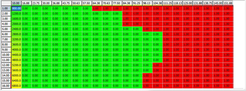

    you *should* be able to hit the limit in any gear if you limit it in S mode.
    Check this out though :), designed for the Tundra, but will likely port this code to the Tacoma.
    (ignore the values in the tables, it's just a representation for this image)
    instead of using the enrich threshold based on throttle angle for S/C vehicles (which honestly sucks...), we designed a 3D table that enables enrichment via 3D engine Speed vs RPM
    eventually the 4.0L will get all of this stuff.
    So you can use this 3D table to set "1" to enrich at any RPM /load breakpoint, then there is another table to set the enrichment amount you'd like.
    nd4spdbh[QUOTED] likes this.

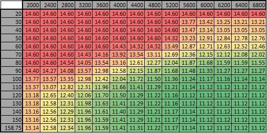

    MMMM smoooth fuel maps, me likey took some time to get my eq map smoothed out.
    Edit - honestly dont know what kinda crack the dude at toyota was doing on the day when he created the stock EQ map..... its about as cracked n jagged as a dude on meth row.

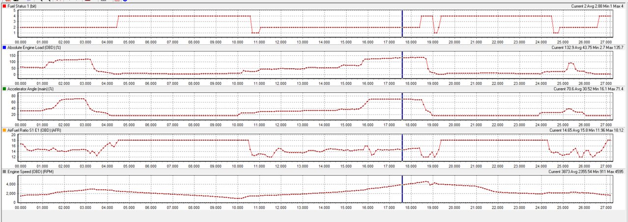

    This table is assuming you have reached the throttle threshold, and or other thresholds. Otherwise it does not target those AFRs at all.
    Here is a full throttle pull showing so. simply tweaking the boundaries to be outside what is actually possible and you will still get stoic at full throttle.
    Very easy to prove it. Set that whole map at 12.5, and show the truck idling at 12.5
    or set your throttle thresholds to 200%, and show it still following that map.
    Simply put the stock calibration logic, how the fuel is controlled, is not the best method for tuning supercharged trucks. That's where our custom code comes in.
    Fuel status bit : 2 CL
    Throttle : Full throttle
    Engine load: 130%
    AFR : still trying to maintain stoic.
    you can see it right in the code.
    Even changing your base stoic (14.6 1D table) in the fuel algo will not change your target afr.

    Incorrect. I can get those and any other AFR independent of throttle thresholds. Keep in mind, those aren't stock values (just random values)
    Would you like me to prove function? Or can you take my word on it?
    I never mentioned changing the base stoic table to be able to change your target AFR? Where did that come from?
    By the way, your logger looks an awful lot like the ecuEdit logger I used back in my EVO days from www.epifansoft.com.

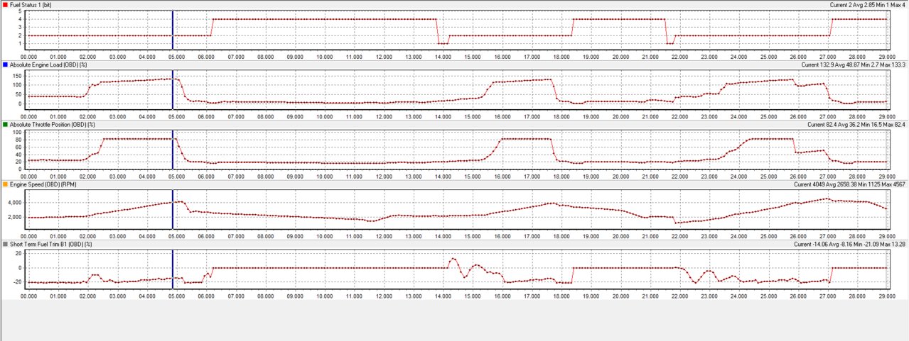

    If the truck is in open loop then of course it will. I'm talking about closed loop feedback, AFR by engine load and speed. The stock code cannot do this.
    Like this, with our patch :
    Close loop
    AFR 13
    full throttle
    fuel trims still correcting.
    In the Tundra, this is not possible to do on stock ECU logic. The Tacoma ECU logic is 99% the same.
    Also on the Tundra, you will not get enrichment until the throttle thresholds are met, or catalyst temps have exceeded threshold temps (which isn't something occurring during normal driving).
    This is epifans logger. Epifan has made custom software just for me.
    nd4spdbh likes this.
