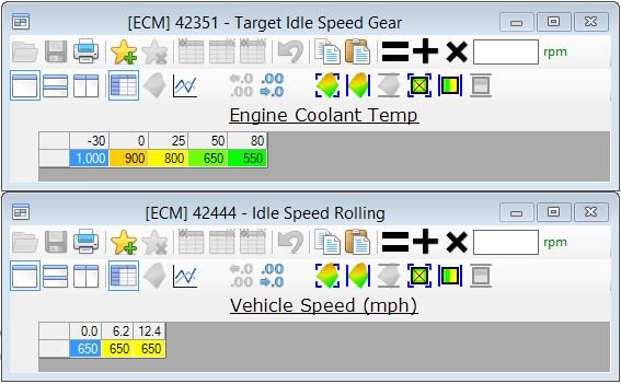

    From the video you sent, I would agree that you're idling a bit higher than you should. However, I should note that there is some trimming that takes place with throttle learning, especially after a reflash or battery reset. Immediately after a battery reset/reflash you'll often times find your truck will have the idle surge from ~800ish-1500 as you coast to a stop while rolling. This is normal, the ECU will trim/learn and correct itself.
    If you're experiencing this, what I do to minimize the surging is right after a reset/reflash, turn the ignition key to "ON" and 2 or 3 times slowly actuate the gas pedal from "zero throttle" to "full throttle" in a smooth and linear fashion giving a slight pause between your actuation. Turn the key off for a few seconds, and then start the vehicle/drive as normal. That should drastically cut down on the time it takes the ECU to trim/learn.
    If your interested, here are the idle speed targets for our Manual Trans trucks:
