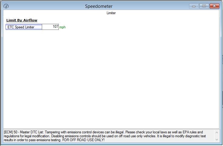

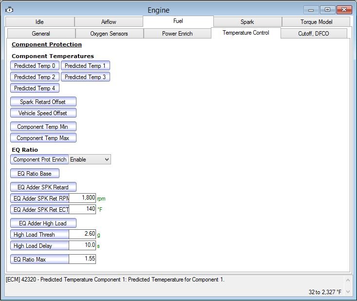

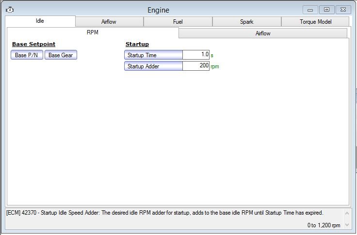

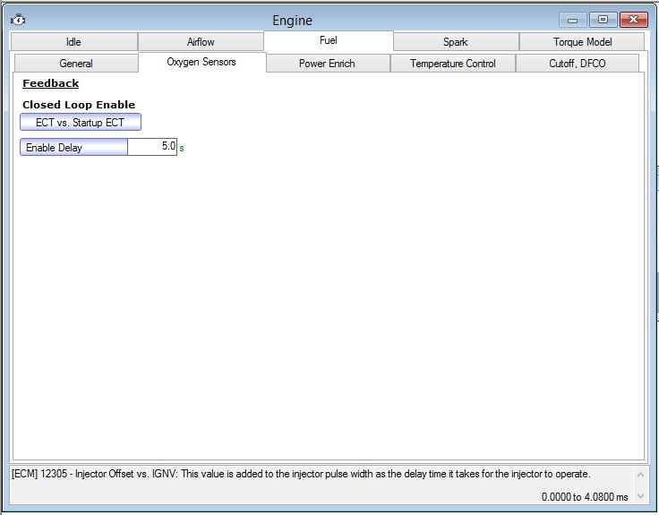

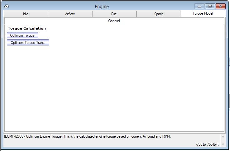

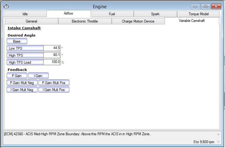

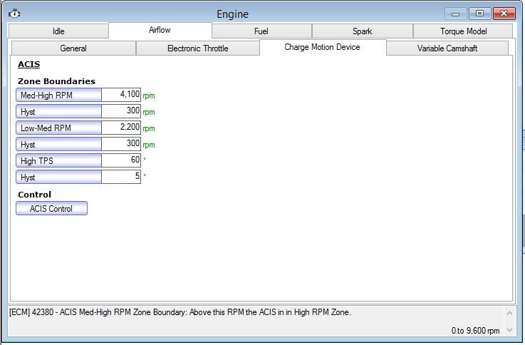

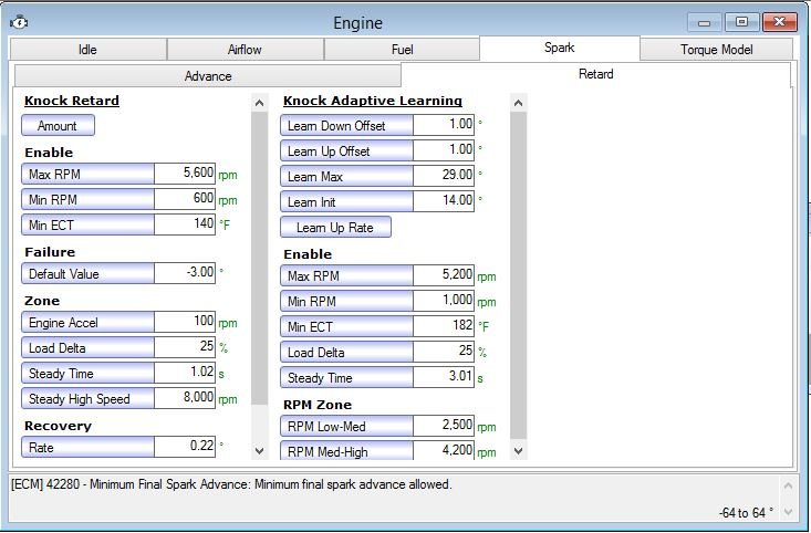

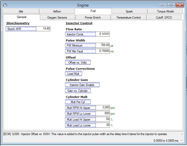

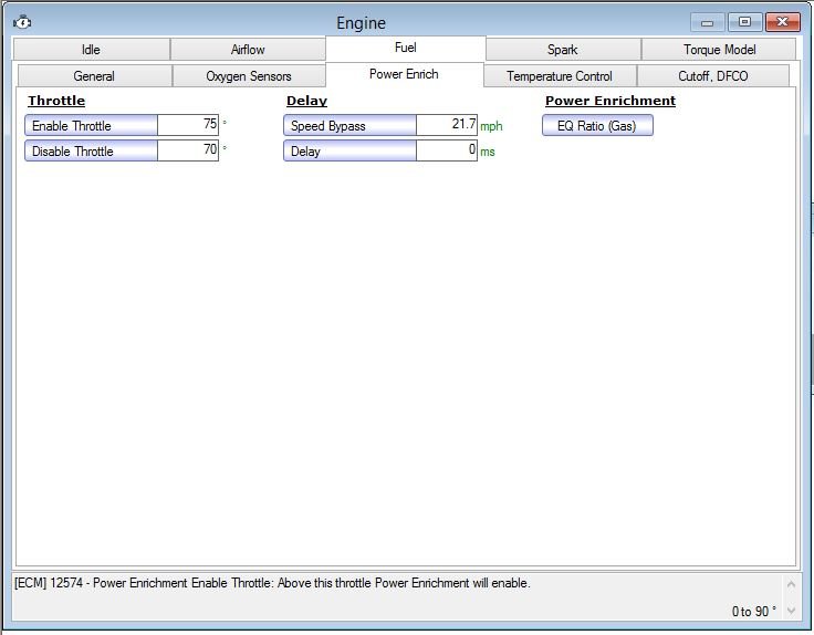

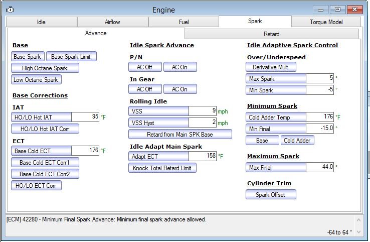

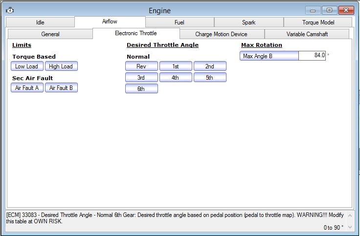

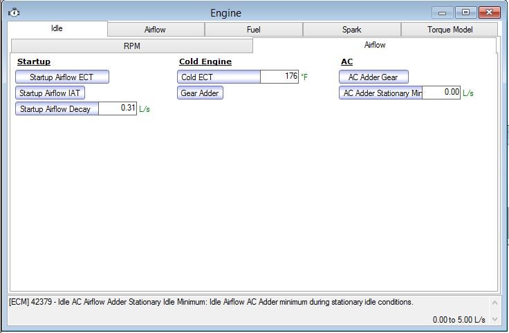

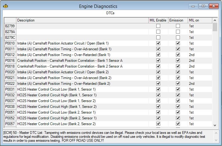

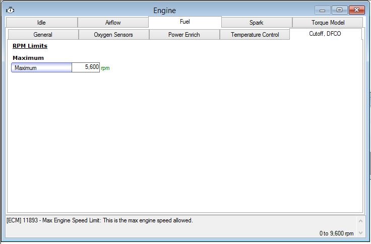

    Alright folks, it's official. You can now reflash/tune your Tacoma ECU. No more runaround and waiting.
    I'm going to blast out these screenshots of my stock 2015 4.0L 6spd ECU. Please keep in mind the transmission tuning and related tables are completely missing here since I have a manual. Also of note, that this is a N/A varient ECU as we've learned these do not have the larger load tables that the TRD calibrations have. So the images and tables here are what is represented *currently* by HPTuners. There's some surprises and letdowns in this (more on this in a moment) but this will do a few things that can't be done with any other option on the market currently.
    IDLE Tables:
    Airflow Tables:
    Fuel Tables:
    Spark Tables:
    Torque Model:
    Speedometer:
    DTC:
  15. Mar 30, 2019 at 5:18 PM

    Is it just me or is there no main fuel table
    Norton likes this.
  16. Mar 30, 2019 at 5:22 PM
    #56
    JustDSM
    JustDSM Oderint Dum Metuant
    Jan 16, 2015
    #146525
    3,311
    Justin
    Ogden, UT
    I too was a little curious about that, but the main fueling is done through the Power Enrichment table under Fuel/PowerEnrich.
    I'm currently compiling some of my initial observations, and this was one of the primary things I was going to cover. The logic used by Toyota for the fueling of this motor (in stock N/A calibration) is a little different from what most people are likely used too.
    I'm going to touch on this more in the next few moments.. I'd like really like to get my hands on a TRD Calibration. Anyone if the DFW or surrounding areas willing to let me read your ECU?

    This screen shot here is of great interest to me. Could you scroll down to the 400’s, 1600’s and 2400’s?

    Might be worthy for me just to get rid of the intake cam gears codes...

    Yes.. This is one of those areas.. :D And it appears to do exactly what you're thinking..
